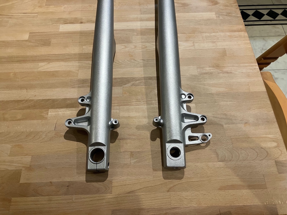

I used this stuff:
https://www.frost.co.uk/vht-engine-meta ... XAQAvD_BwE
Very happy with the results:

If you have a 2010 or earlier model with fork legs like mine then an abrasive pad - I think I used 3M scotch-brite pads - did the trick followed by a good clean with thinners. For the 2011 on bikes something more sophisticated would be required.
Removing the fork sliders is very easy. I just removed the mudguard, took the wheel out, undid the fork brace bolts and pulled them down. I took the opportunity to remove seals and change oil but that was very simple - the oil is only there as a lubricant, there is no damping going on. Doing this and powder coating the footrest hangers transformed the appearance of the bike.
The only problem I had was that one of the mudguard bolts sheared off in the fork leg - I had to drill it out and use a helicoil.
