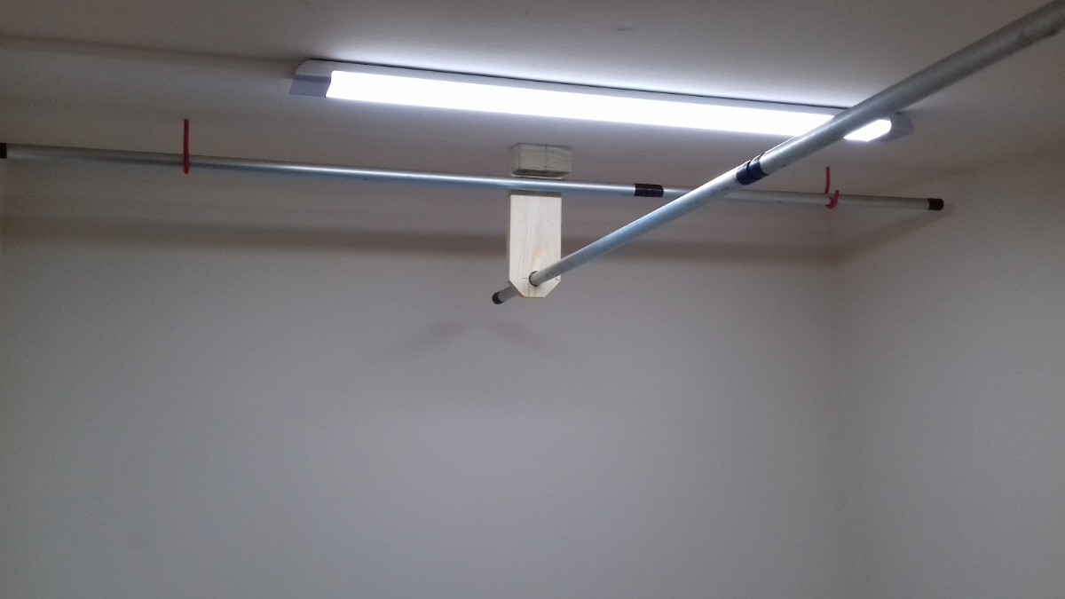

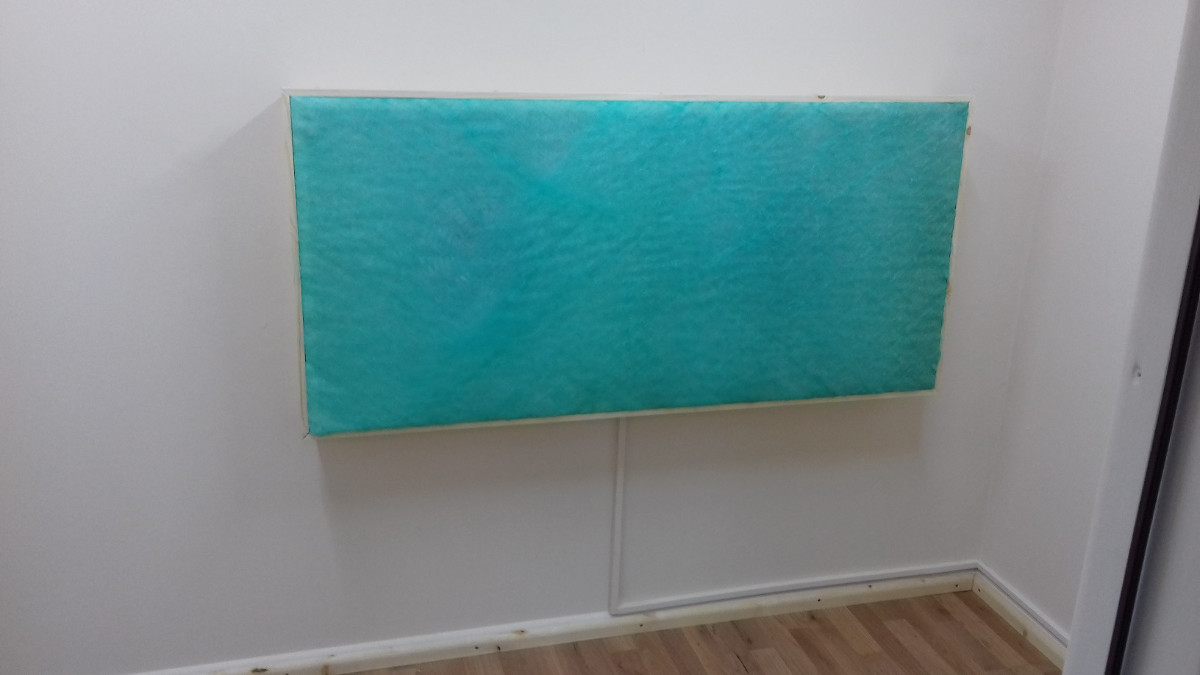

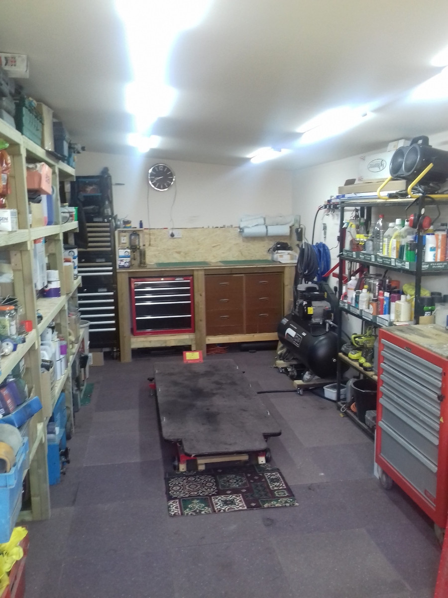

This is my toy room. When this photo was taken it was 22ft x 10ft.
But i turned the bottom end into a small spray booth which is 7ft x 10ft.
So the workshop is now just 15ft x 10ft.

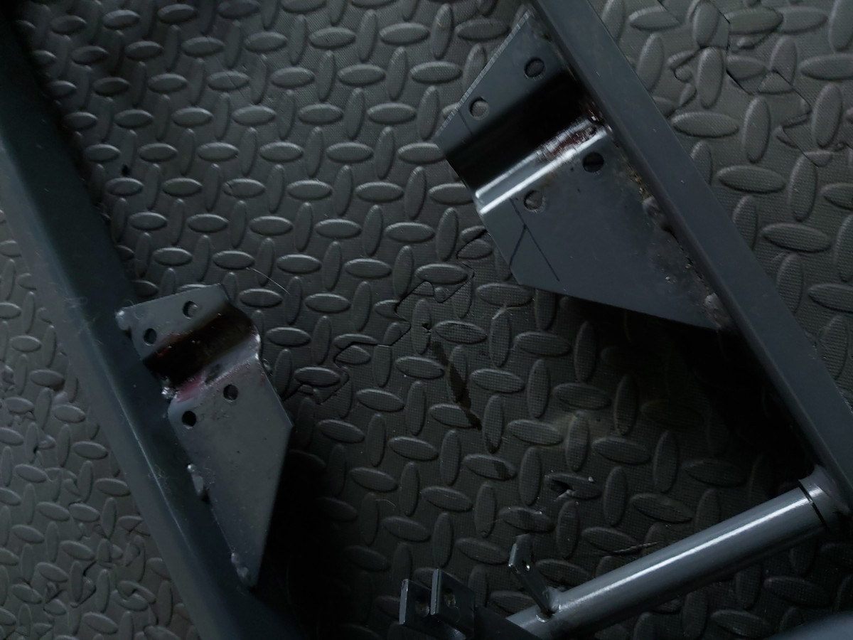

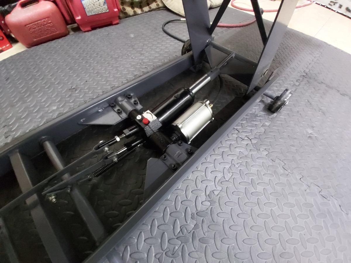

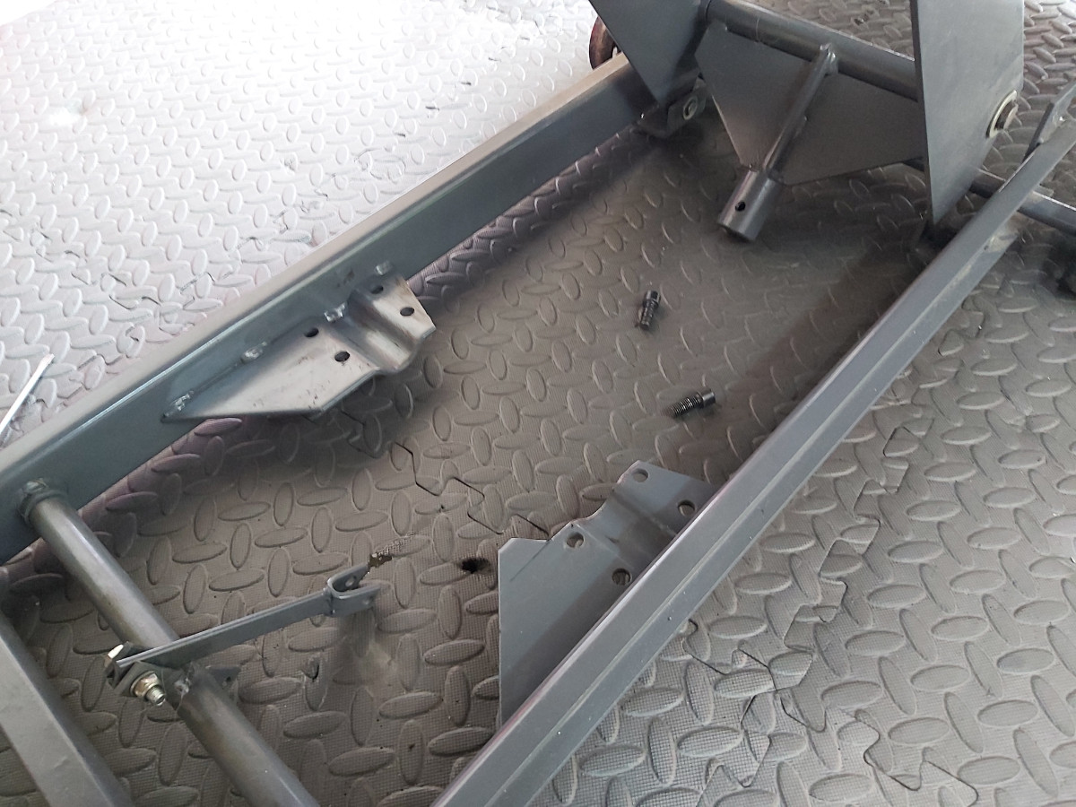

So i now have to new ram fitted and working.
I had to cut part of the mounting point on the bench lift.
This is because of the Pneumatic side of the ram is wider.
Only had to remove about 2cm from the mount.
Everything else lined up and works like it should.

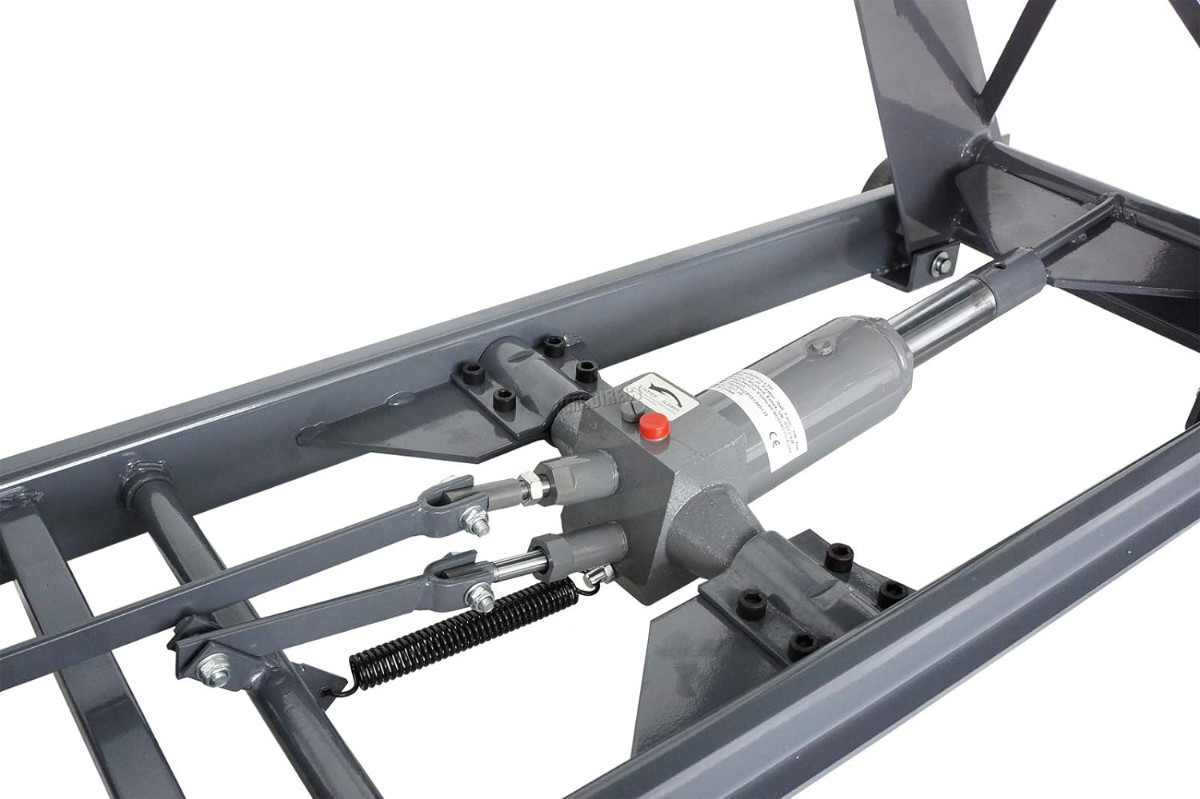

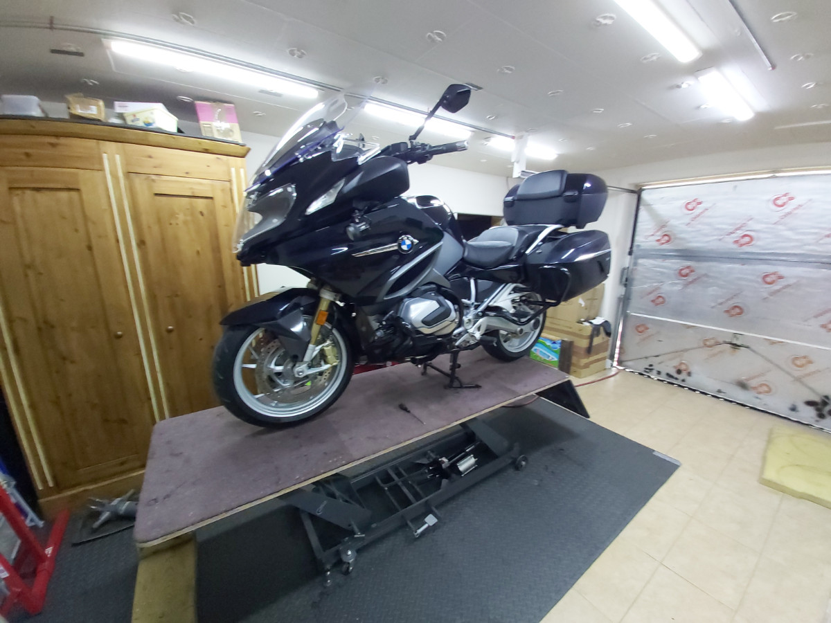

Here are some photos. The first photo is not mine, but it shows you the old ram.
You can also see how much bigger the bed is with the plywood fitted.
Its about 6" wider than the Abba stand when i use it.
