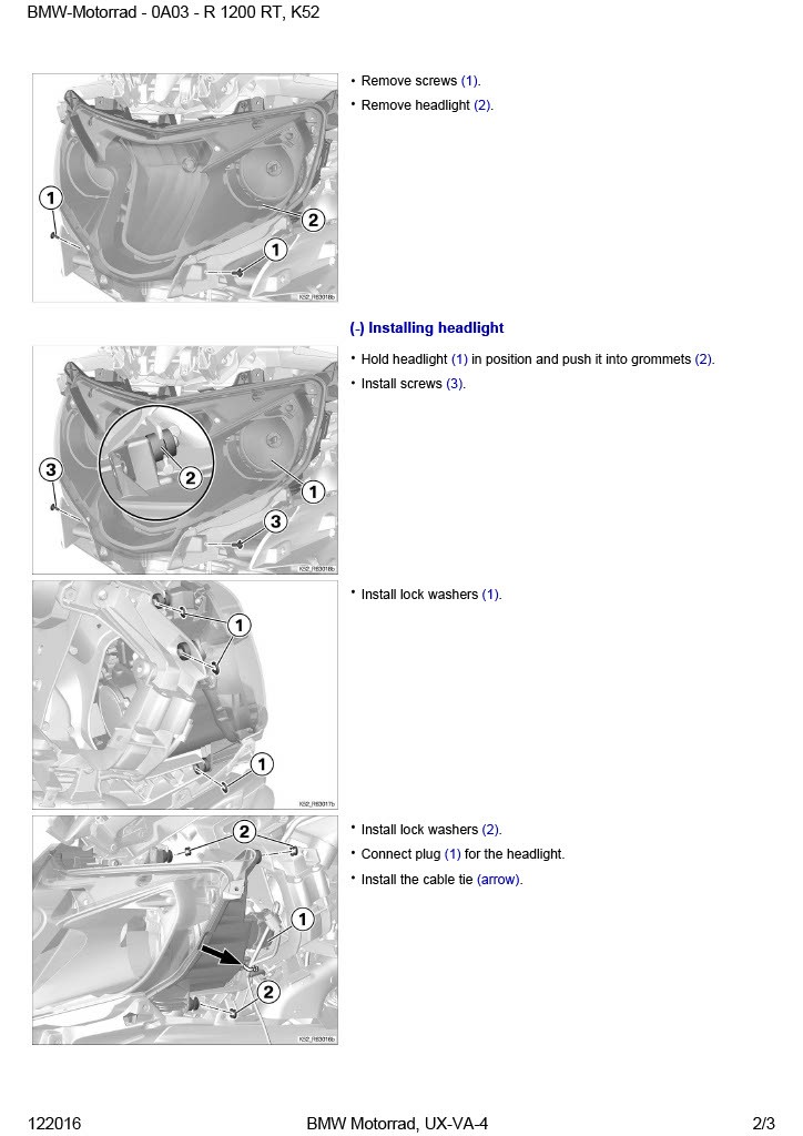

Hello everyone. I’m new to this forum and I am glad I found it!
I am trying yo remove the headlight as I want to upgrade to LED bulbs. I know it is possible to do this without remove of the headlight assembly, but could not do it.
Can someone please help me understand how to remove the top fairings? There’s a screw on the top fairing next to the mirror that I can not remove without breaking it. Are there any tricks?
Thank you for any advice

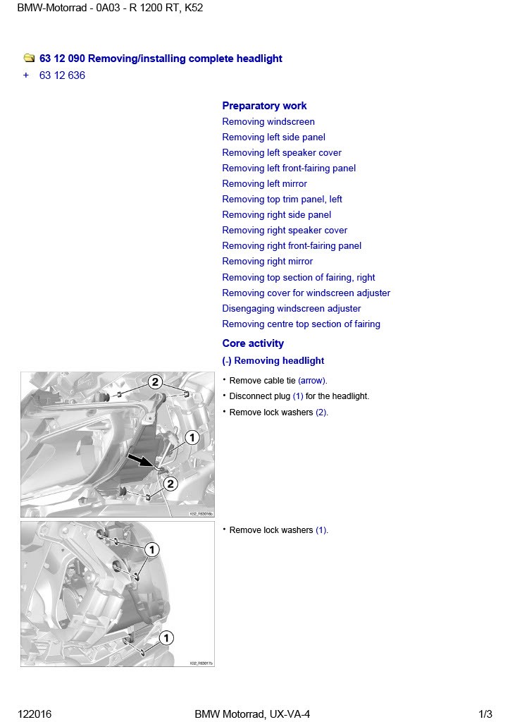

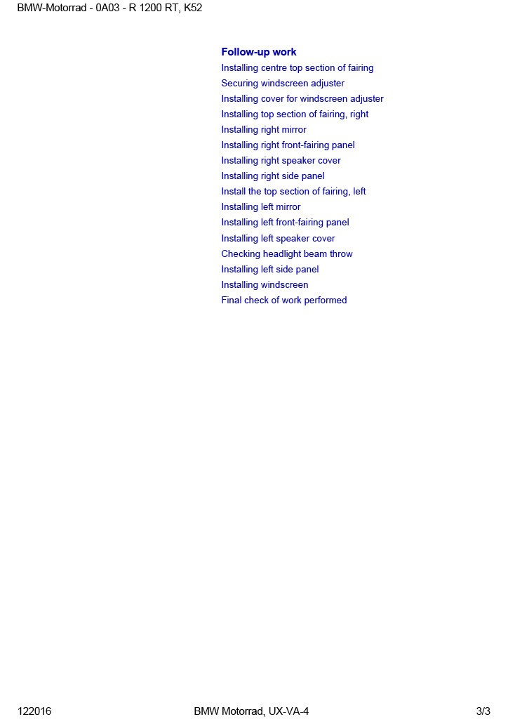

Take a look for the headlight here, it may help
- 1704405399079-6d9bfc4a-54c8-4157-bb18-b4ac3c2577e8_3.jpg (52.14 KiB) Viewed 5193 times
- 1704405399079-6d9bfc4a-54c8-4157-bb18-b4ac3c2577e8_2.jpg (99.69 KiB) Viewed 5193 times
- 1704405399079-6d9bfc4a-54c8-4157-bb18-b4ac3c2577e8_1.jpg (98.57 KiB) Viewed 5193 times

thank you for the information, this will help with the removal of the light.
Could you please send the link to the information on removing the top fairing panel? I can not open it from the link you sent.
Thanks again
