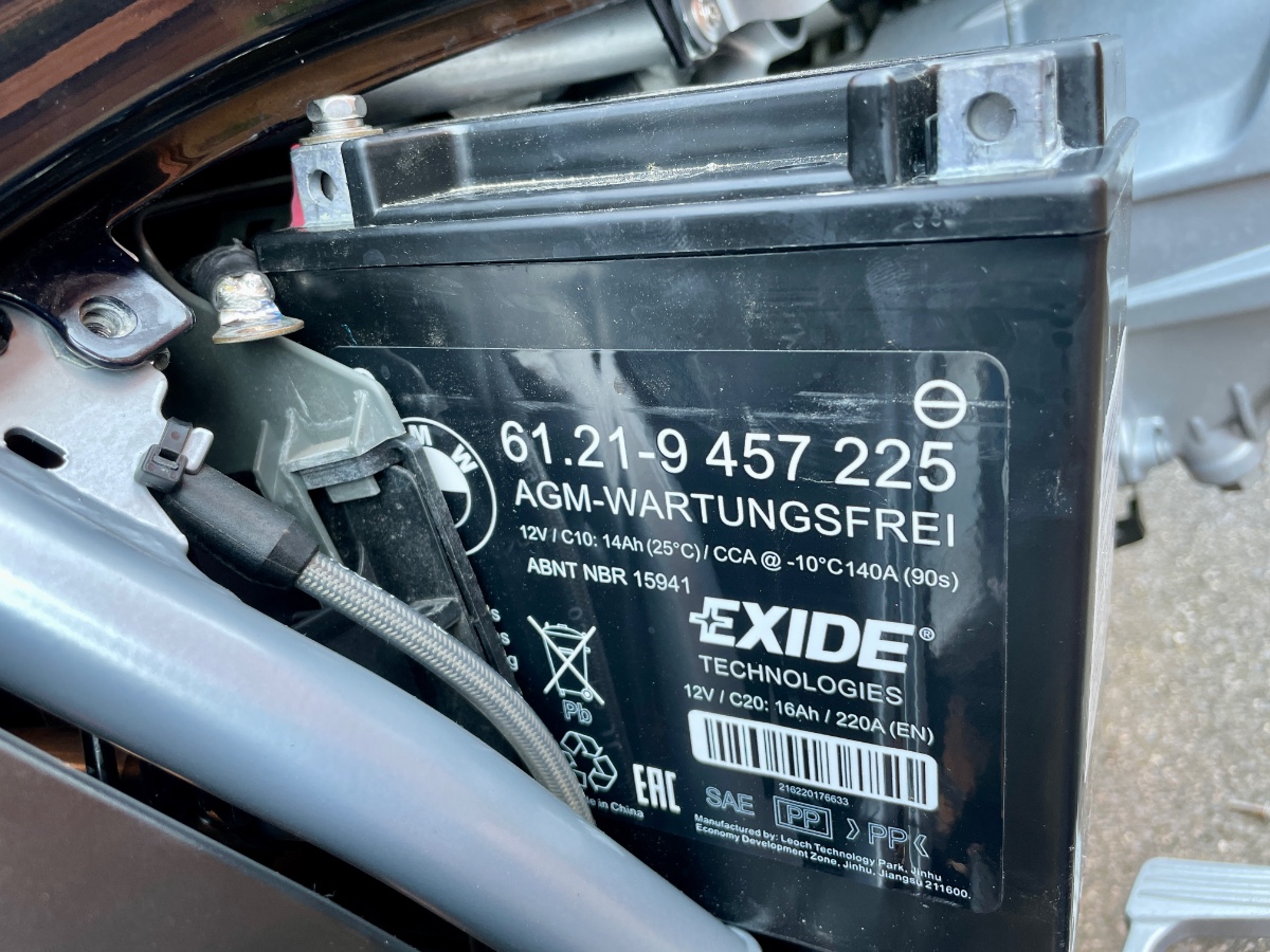

So the ones of you who have had your RT for some years, can you tell us new owners how long your battery last.
The last owner of my RT had a new battery fitted by BMW in January 2022. I had to have a new one in December. So just 2 years the last one lasted.

Also note that BMW changed the specification as a result of starting issues to a higher specification CCA. This will have impacted the life of some bikes fitted batteries as they would have been working relatively harder. It will be difficult to work out the usual lifespan, but could explain the shorter than expected ones. Mine was changed last year. I have a tracker fitted as well as the alarm and I need to keep mine on a CTEK if it is not used for more than a couple of weeks. I use the fairing socket during the riding season and in the winter I have a pigtail under the seat I use to avoid the bike waking up all the time.

The Exide battery on my 2012 Camhead is 5 years old. The bike has been stood for over 3 months. When the battery is put on charge, it always goes straight to maintain voltage. GEL batteries seem to be the best for holding their charge when not in use. Fired up the bike today, it started at the first push of the button.

My 2020 showed signs of problems about four weeks after I got it second hand last January. When I questioned the dealer i was told unoficially that the new 1250's eat batteries. I was given a deal on a battery charger and told to keep it hooked up when not in use, which I wasn't happy about but did anyway. Last Sunday after a round trip of about 150 miles it was slow to turn over, so I've looked at a replacement. Do I go for the Exide from Nippy Normans which is the battery BMW fit without the sticker or a Yuasa from Tayna? A lesser man might thing that BMW didn't design a space big enough on the bike to fit a battery that could handle the drain.... ;)

My local Halfrauds online say they have a Yuasa in stock for £78 which is cheaper than the Exide with postage from NN and Tayna but I have to collect in store which is about 8 miles each way, CCA's on Yuasa is 230a while Exide is 170a. Question is do I stump up the dosh for a better battery knowing the RT may eat it?

I bought the Yuasa YTX20CH-BS from Tanya, same size as standard but higher rate, and recommended by Yuasa for the RTLC.

Thanks for that, interesting thing is when I looked at Tayna for this battery to order it, it came up with the EXIDE ETX20CH-BS as a star buy in this size with 230CCA's....at £ 55.57 the same CCA's as the more expensive Yuasa I was going to buy originally... :| :|
