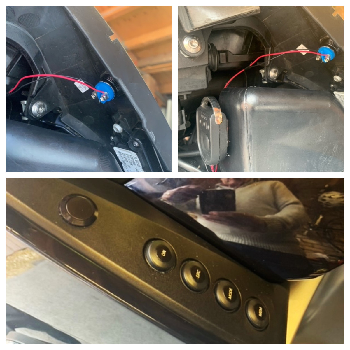

Something I've been wanting to do for a long time is to fit a press button somewhere on the fairing so when I get home I can press the bottom as I approach the garage and ride straight in. I looked at several kits, all horrendously expensive and overly complicated so I made my own! I now have a fully functional and discretely mounted garage door operator in my RT.

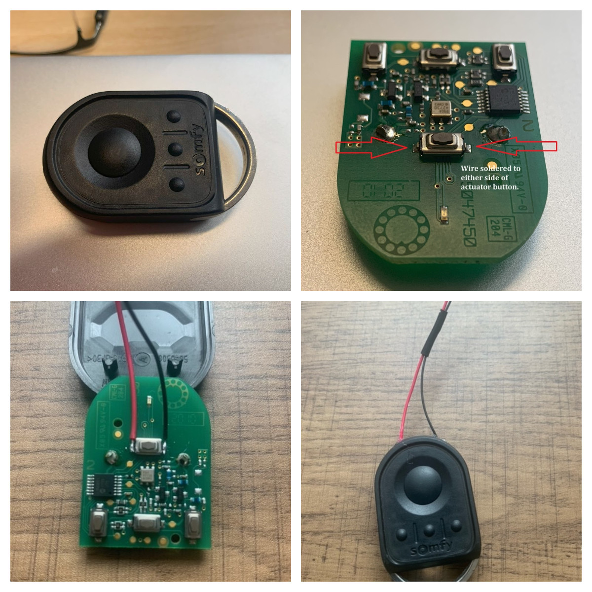

1a. The original remote control. As you can see it's got a large press button on the front.
1b. Opening it up shows that button is pressing onto a tiny button on a circuit board.
1c A friend soldered two wires to it for me.

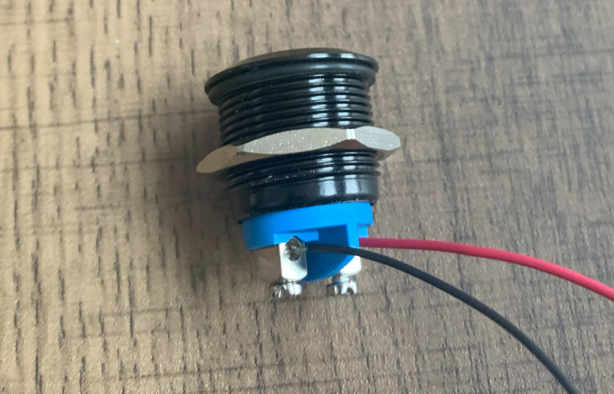

1d I drilled two holes through the case, fed the wires through, sealed the holes and reassembled. At the other end of the wire goes a sprung loaded momentary push button. It works exactly the same as the main remote and the one I chose is allegedly waterproof.
2a Note O-Ring under the flange for weather proofing and the thin 'nut'.

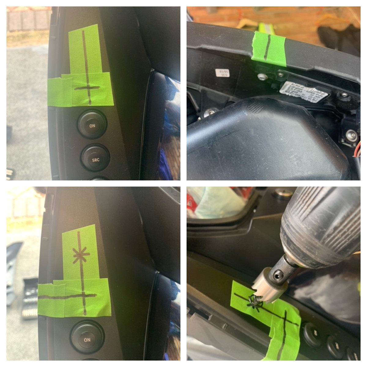

2b Two wires, dead easy. Remove the Fairing Panel - Measure it twice, cut it once.
3a. Where I wanted to put the momentary switch was carefully measures so the new push button would be in line with and have the same centre to centre measurement as the OEM Radio buttons.
3b Unfortunately the screw holding the case the radio buttons are in was in the way.
3c So I had to move it up an inch or so.
3d Drilling the hole. That's the, right I'm committed here now moment! Installation.
4a The momentary push button needed to be pressed through hole, the wires reattached, but the nut was impossible to tighten with a spanner, so finger tight & threadloc it had to be. It shouldn't vibrate free and even if it does, as the button was tight fit and isn't going anywhere fast.
4b The original remote control was attached to a plastic mounting with a 1" square of self adhesive heavy duty Velcro. This will allow it to be easily remove when the battery needs replacing. Everything behind the fairing panel looked dry and that rain or spray doesn't get in so the original body of the remote control should be safe from the weather.
4c. The finished job. I'd have preferred the push button to be a little closer to the radio buttons, but the aforementioned screw was in the way so there's a bit of a gap. By next week I'm sure I won't even notice it. Anyway, everything works, the button is in easy reach and looked neat enough for me.

The actual doing bit wasn't that bad, just took a bit of courage to drill the hole! The remote was sitting unused in the spares drawer, the push button cost £8.00, the hole cutter £5.20, (both from Amazon) and the soldering & wire a beer.
Quite cheap and in the end easy to do.

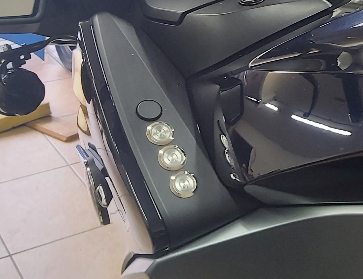

Great job there Capt. I did sort of the same. I dont have a radio so used the holes that were already in the panel.

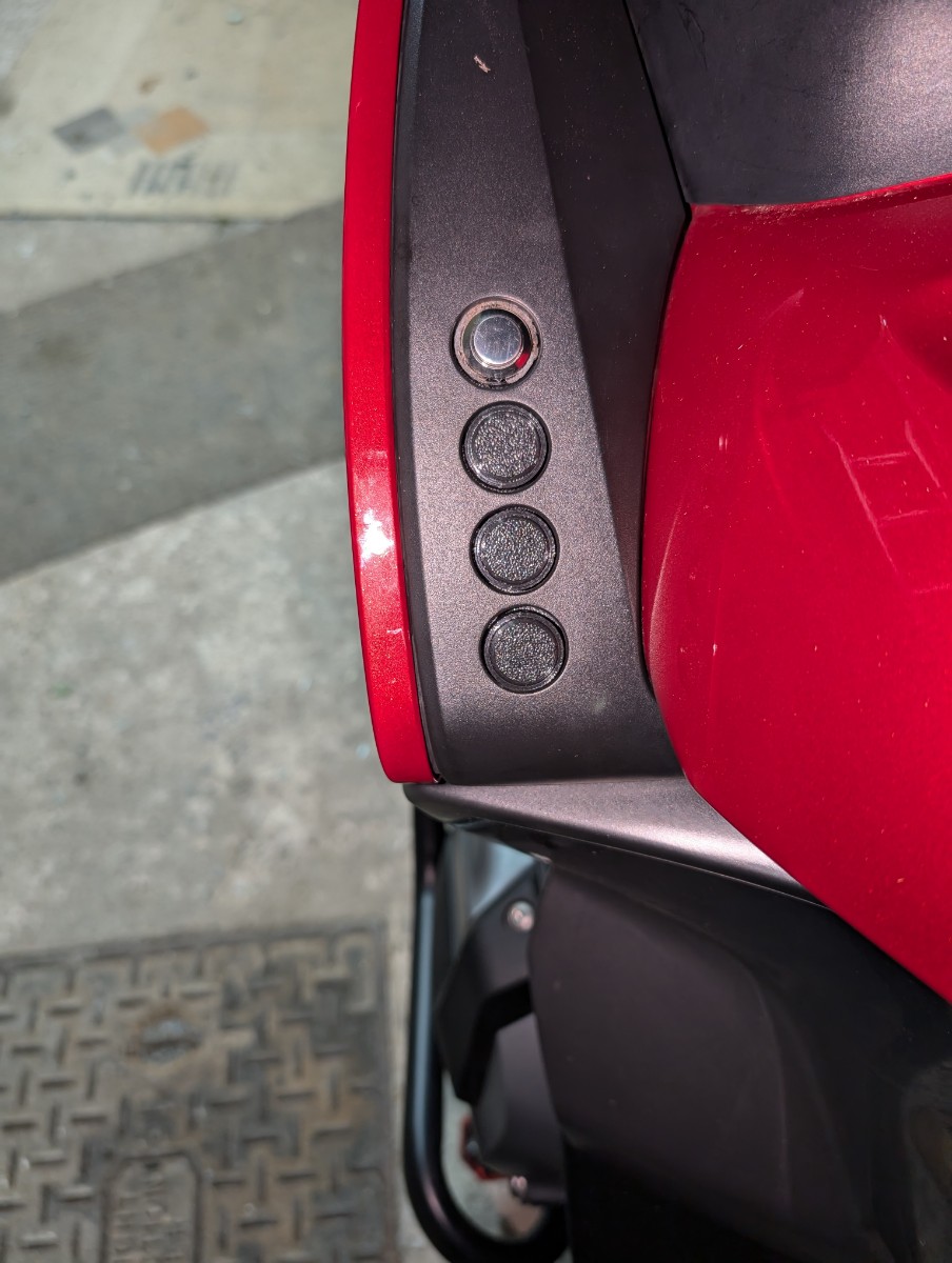

I've just fitted mine to the bike, I removed the blanking plate and fitted a 3d printed mount/box, stl attached (credit to Boite Bouton lumineux étanche by ebraud on Thingiverse: https://www.thingiverse.com/thing:3561910) and 3 cap blanks.
