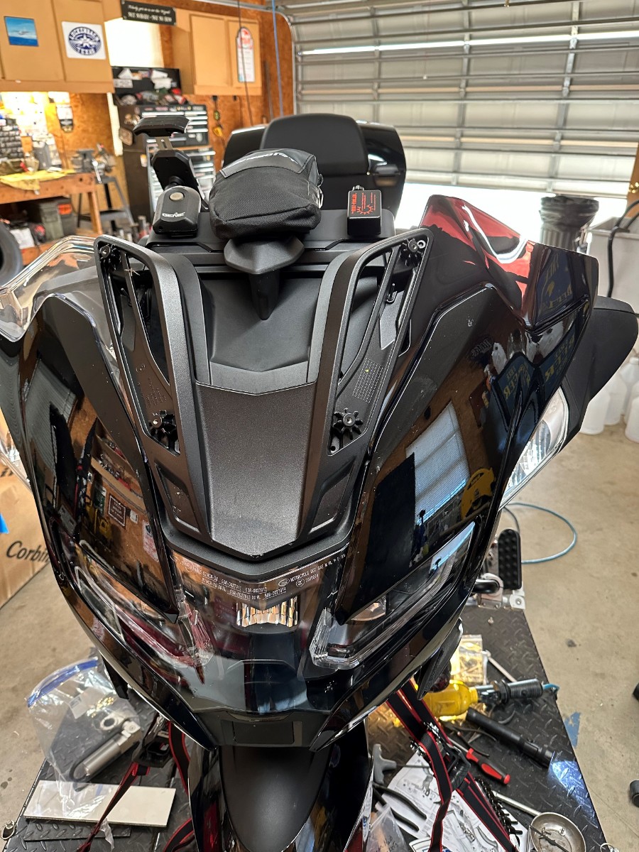

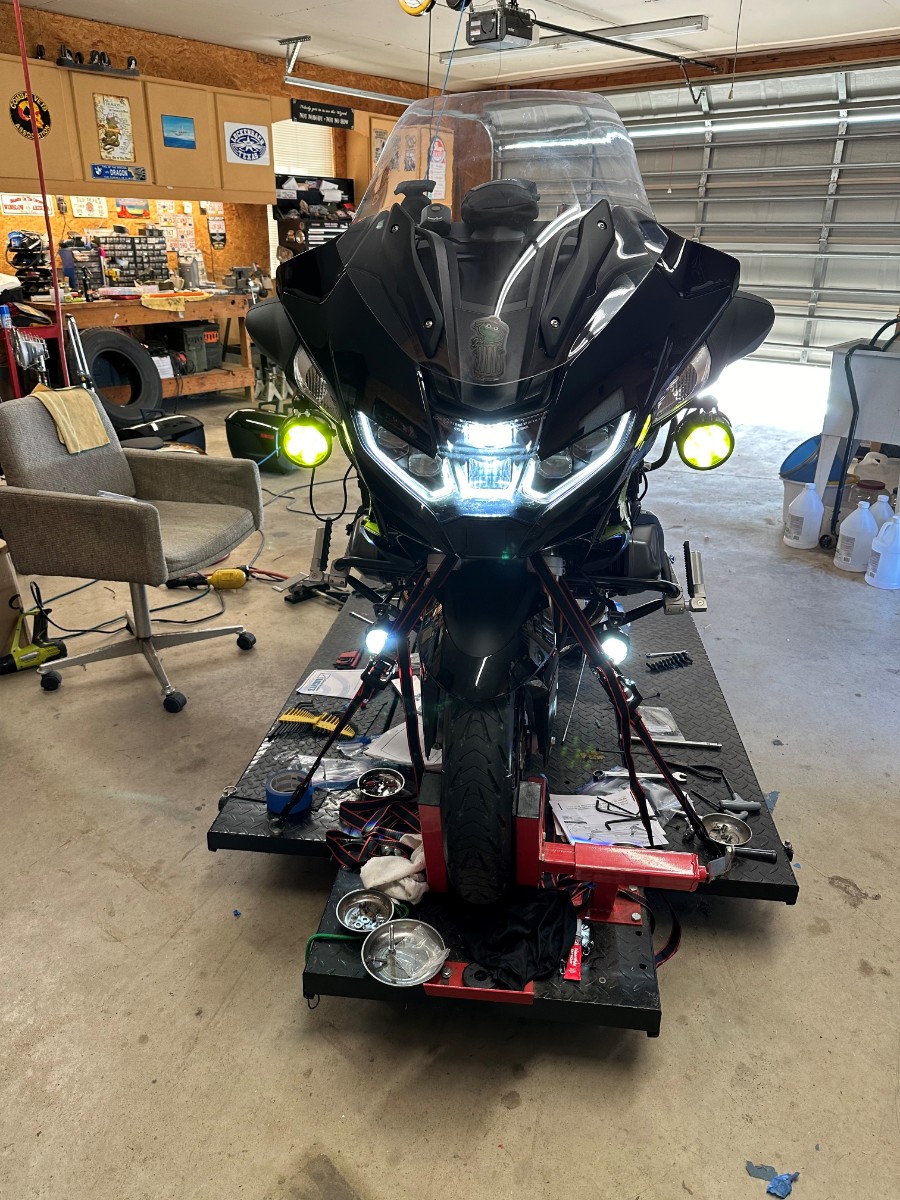

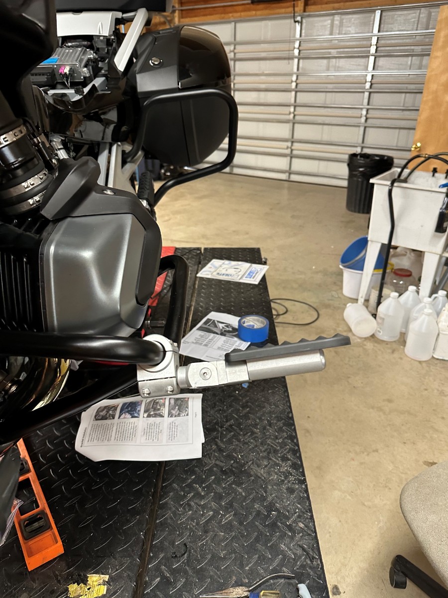

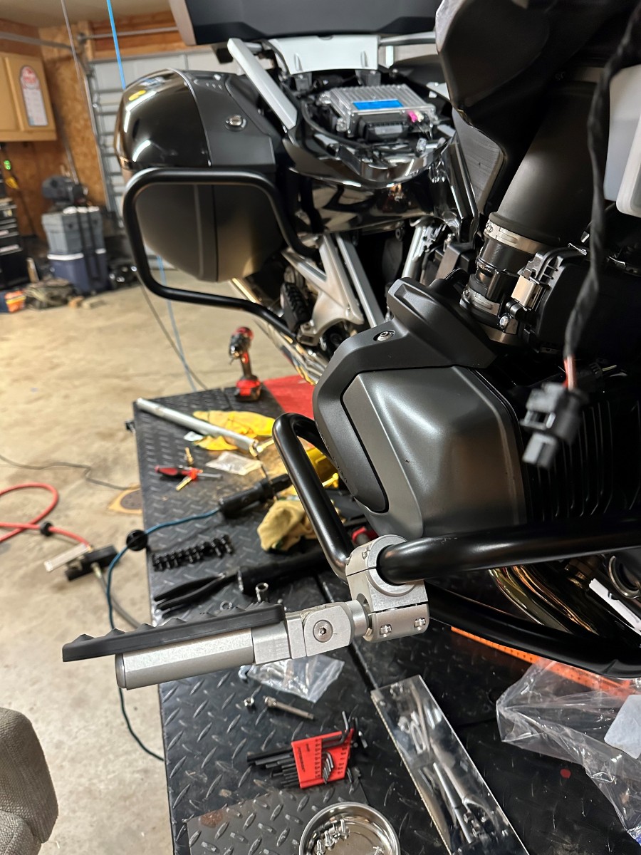

I just finished putting some Farkles on my 23 R1250RT "night fighter" Among those were Crash bars (made by Baione) and ilium Highway pegs. While the pegs are expensive (took them off a previous 16 R1200RT) and I will someday put black ones on the black Crash bars. Until then, these will do just fine mulitple adjustment angles can be made. I think my mods turned out pretty good
