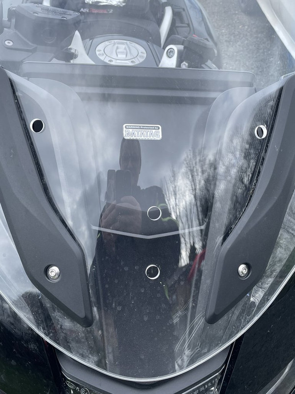

I fitted a Power bronze touring screen to my 22 RT and felt that although it was better than the original, the added size meant I was getting a bit more forward suction from the low pressure area that builds up behind the screen. My solution was to drill 4 x 13mm hols in the screen to see if this helped - and it did, there is no down side to this, the holes are small enough so as not to affect the strength of the screen, kept away from stress points, and there is no wind noise, which was a concern, best of all ....... it works, and there is now less pull than on the OEM screen :P

Wow, that’s a brave move. Not sure I would have the balls to drill holes in my screen. Respect. :cheers:

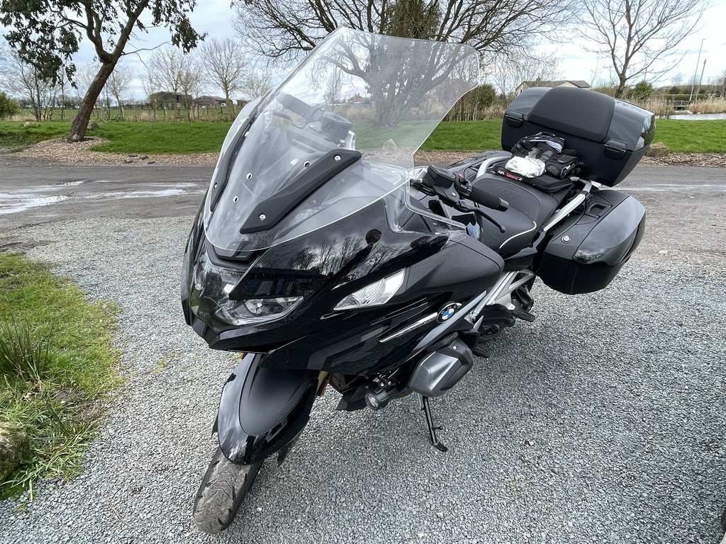

Mine looks like a couple of inches taller and a different shape at the sides, it does not look much when next to each other, but there is a big difference the way the air is directed over and around you, for the money I paid for it (new) it was a bargain, I'd buy another in the future.
