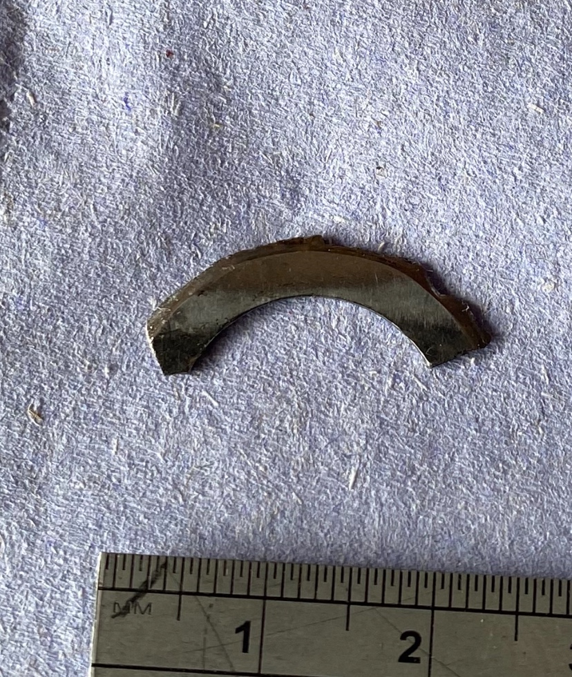

Hi, If anyone has lost a small metal ‘thingy’ the good news is I’ve found it! The bad news is that I found it sticking out of my back tyre!
The next bit of good news is the pile of cash my local motorcyle emporium is about to receive.. :|

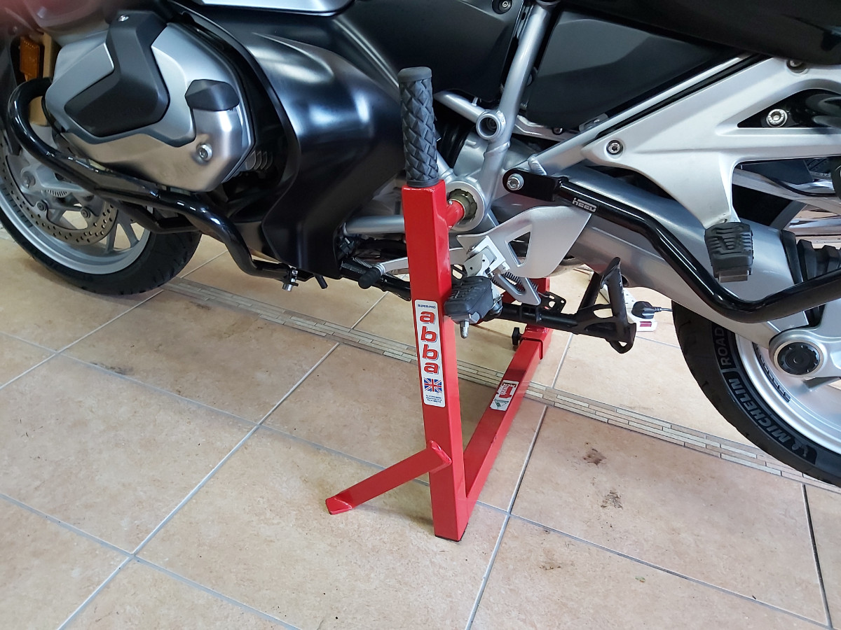

I do like using the Abba stand. I think i posted this photo before. Because of how high it lifts the rear wheel, its not that easy to use on the RT. I will only use it when the front end needs something doing to it. The main stand for everything else.
