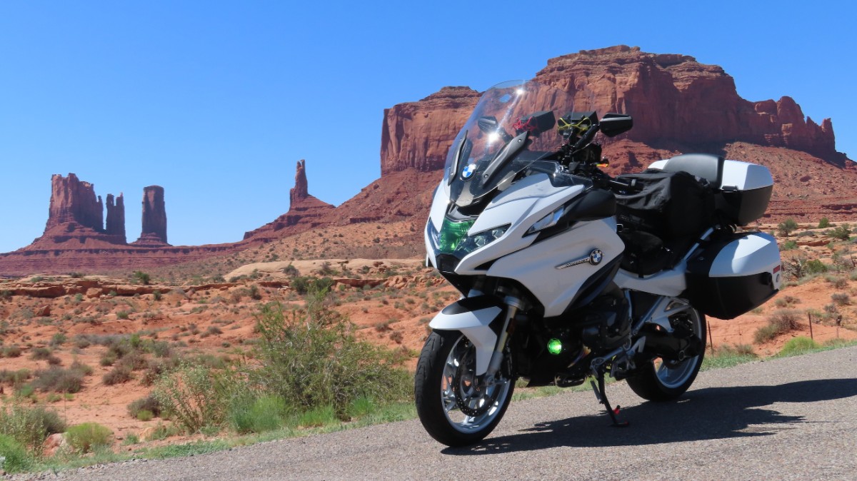

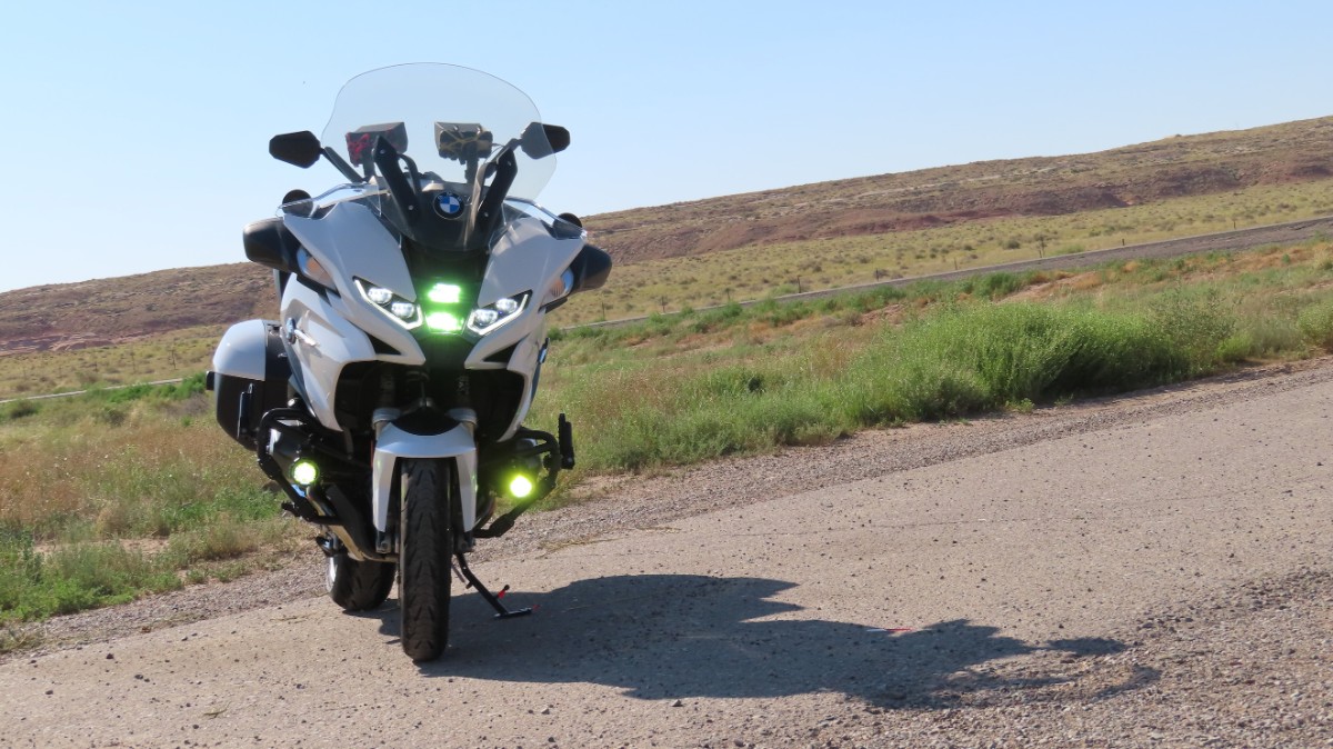

I just returned from a trip to Colorado, and got to use the mirrors, and see how they work.
Pros
(1) Easy to see behind/side of you, at a quick glance w/o having to look down at the 12" lower stock mirrors.
(2) Because they're closer to your eyes, you get a nice wide field of view.
(3) Easy to adjust, on the highway, I had them adjusted more to the side view, in areas with more traffic/cities, more to see behind.
Cons
(1) They vibrate more than the stock ones, because they're mounted on the handlebar, and not on the body of the bike.
(2) At full lock when parked, they can hit the screen, needing an adjustment.
All in all, they are an improvement over the stock ones. Even with the vibrations, you still get a good picture through them, even though the stock mirrors are dead stable. After starting with the arms at a 30 degree angle, I found the sweet spot was more to the outside at about 50/55 degree angle, (This eliminates the shoulder view). In the pictures you can see how much higher the are over the stock ones, and if you zoom in you can see what's being shown in them. Also there have been a lot of comments about how my GPS/Phone/and mirrors interfere with my view, but you can see they all are below the level of my helmet, and I'm looking over everything, including the windscreen.
