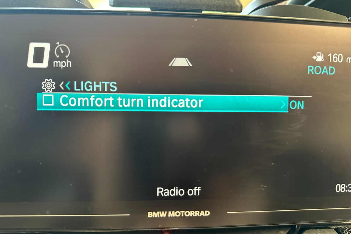

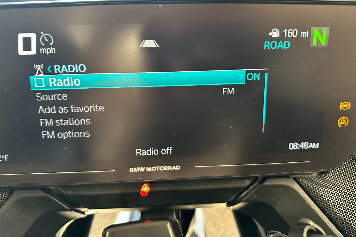

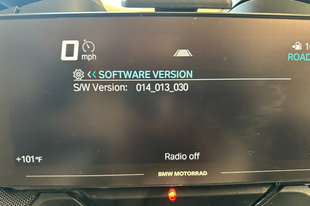

Hey Guys,
Before my latest trip, I took my bike in for service, and they also updated the software to 014-013-030. On my trip everyday, I would have to go into the settings, and turn on (Checking the box), for the "Comfort turn indicator", and also the radio (See photos). This was a PITA if I forgot to do it before heading out, as you would have to pull over to do it, as the bike can't be moving to adjust vehicle settings.
Has anyone else having this issue, or am I not doing something correctly, as I didn't have to mess around with this before???
Thanks for any help.
Steve
Steve

I wrote down all of my settings, and then did a factory reset. I then reprogrammed my settings, and will check them all in the morning, fingers crossed.
Steve

Yes. Sometimes the radio turned itself ON after an ign. cycle even if I had it OFF prior to shutdn. The radio vol. would start at approx. half scale. The eq. & vol. settings would often reset to 0.
Dealer updated SW to ver. 14_12_21 in June & so far these issues have been resolved.

I have exactly the same problem with my 2023 R1250RT resetting the Comfort Turn Indicator to the off position each day. I suspect somehow there is a software bug that causes this reset at the same time the trip #2 data gets reset. It doesn't reset when the bike is stopped and restarted, just when it is left overnight. I thought I was going mad. or madder.
This started after the last software upgrade in July so is probably a bug. I am talking to the dealer tomorrow.
Yes same software version 014_013_30
I also noticed that this software version clears the split screen at the same time as it resets the comfort indicators to OFF. On previous software it kept the split screen mode indefinitely between trips and days, and I always ride with navigation map in right section of screen. So every new day as well as turning comfort indicators ON I have to push the wonder wheel 3 times to the right to get the map screen up. Pretty ordinary coders at BMW me thinks.
I think Steve and I just happen to be the first to pick this up and work out its actually a fault. Has taken me 4 weeks to realise I wasn't failing to turn the option ON, and it was indeed the bike turning it OFF between trips. Including resetting the split screen.
Grant

After further thought I realised that my problems started well before the upgrade to 014_013_030
I had to have the keyless ride module replaced in May and it took 6 weeks and the final step was reprogramming the bike using a laptop and software that connects to Berlin (so I was told). Since then I have had the Comfort Indicator and split screen overnight resets. The mid July upgrade to 014_013_030 didn't change anything.
Dealer is going to troubleshoot when his head technician is back from leave.
I think the software update in May had a glitch which left some firmware flags set incorrectly, Dealer says this sometimes happens and sometimes there is actually a software problem but BMW is not particularly forthcoming on answers, so they have to do a lot of the troubleshooting themselves. makes sense. My BMW workshop here in Hornsby/Sydney are very sharp at fixing issues and I expect once they start looking at the bike they will nail the issue pretty quickly
I will update you when I know more.
