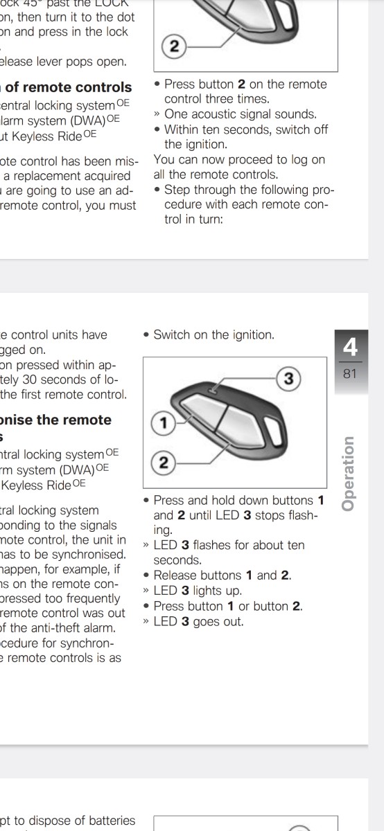

"If the central locking system stops responding to the signals from a remote control, the unit in question has to be synchronised."
The procedure for synchronising the remote controls is as follows:
Switch on the ignition.
Press and hold down buttons 1 and 2 until LED stops flashing.
LED flashes for about ten seconds.
Release buttons 1 and 2.
LED lights up.
Press button 1 or button 2.
LED goes out.

From manual. not sure what your asking Stu. Mine is keyed ignition but can activate central locking from handle bar button or key fob. Activate alarm from key fob only as far as im aware. button 1 locks, push 1 again alarms, button 2 unlocks and unalarms one push. if remember correctly. if push buttons or hold to long fob unsyncs from bike so follow procedure to sync again.
- Screenshot_20241021_075640_Drive.jpg (137.73 KiB) Viewed 3221 times

@BoB21 my questions was aimed at the author of the thread as there is two types of fob depending on if you have keyless ignition or not
If you have keyless ignition it's all built in to one fob

If the keyless fob doesn't have an LED, does this mean that the fob with an LED belongs to a motorcycle with keyed ignition and remote central locking.
Is this the keyless fob.
Fob with LED.
