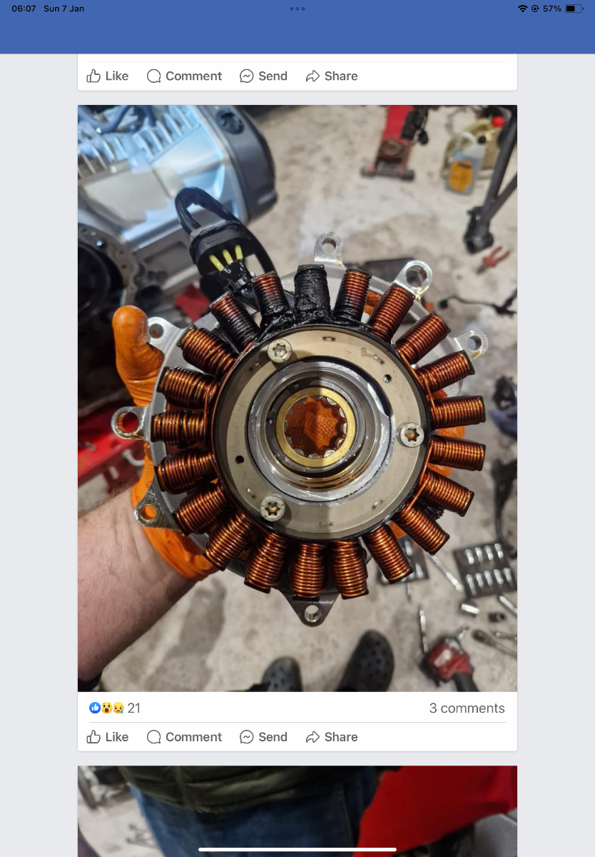

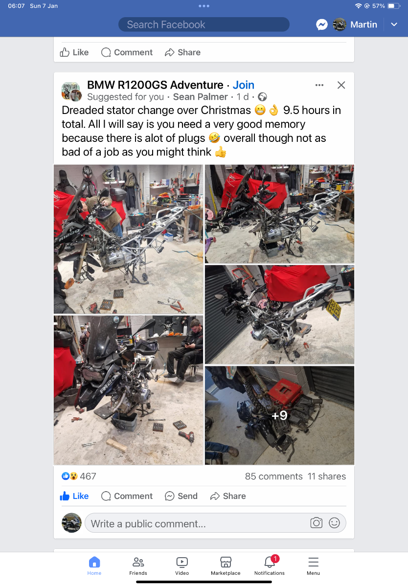

Just going through facebook and come across some guy who had to swap out his stator on a gs1200, I’ve heard of this before but what a nightmare job if it ever goes pear shaped !!, apparently a £2.5k job at a dealers. :o

Yep, 2014 and early 2015. We had a stator replaced on a 2014 RT, £2400 at mates rates 4 years ago.

The issue with the stators wasn't recognised until early 2015, that is why quite a lot of 2015 bikes will also have the original stators. It doesn't seem to be a mileage thing, the bike we had done was a RTp and the issue started around the 40k mark. My own bike which was a 2014 was traded at 40k in 2019 and was still fine. A friend of mine has a 2015 bike with about 20k on the clock and his bike is exhibiting stator problems.
Once BMW fitted the new designed stators, I haven't heard of any failures regardless of mileage. Also have had a LC RT since 2014 and run a fleet of them since 2016 and we have never had a switch failure.
