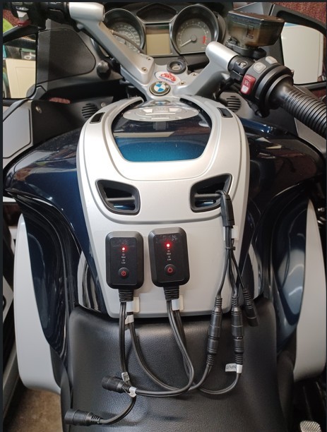

On my 2012 Camhead, the Keis controllers are mounted like this.
Jacket & insoles independent of each other and heated grips/seat.

I thought you mothballed your bike for the Winter? Do you need all the extra heating...?David. wrote: Mon Dec 01, 2025 3:51 pm On my 2012 Camhead, the Keis controllers are mounted like this.
