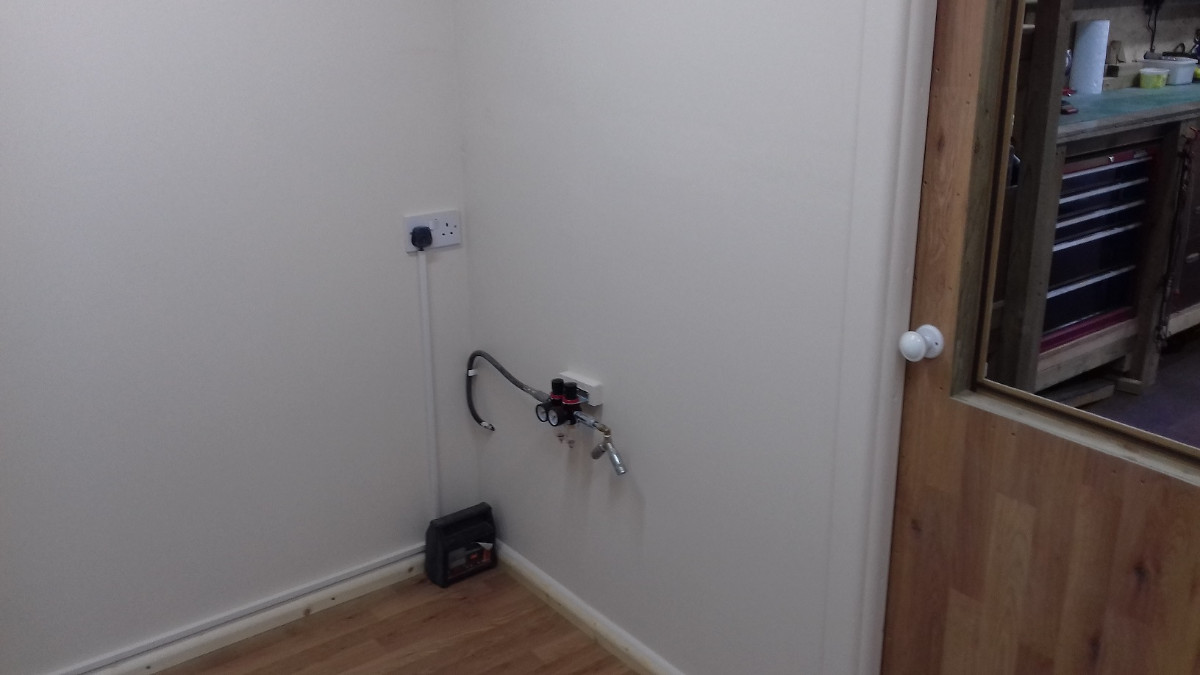

This is my toy room. When this photo was taken it was 22ft x 10ft.
But i turned the bottom end into a small spray booth which is 7ft x 10ft.
So the workshop is now just 15ft x 10ft.
