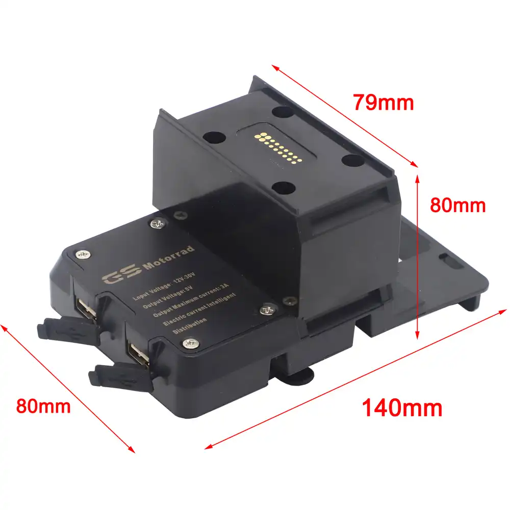

Bernman wrote: I would like to use my mobile for navigation on my 2013 1200RT, currently with a Garmin IV cradle.  I see there are adapters for mobile phone that will make this pretty easy but they don’t say it’s specifically compatible with ‘13 RTs or a Garmin IV.  Are the Garmin cradles identical in the IV, V, VI’s?
Something like this should work in the 4-button mount. However the depth of the surround for the 4-buttons might be a concern.
The extra depth of this mount for the 2014-on RT should raise it well above the 4 buttons.
You could buy both types and send one back. They are available on Amazon as well.

Looking at these dimensions, they are very similar to those of a Garmin Zumo 660 which will fit into the BMW 4 button mount.
The extended version for the LC RT's will be to allow access to the USB sockets, which would otherwise be shrouded by the dash console.
At £24.02, it's also costs less than the one listed for a GS at £41.45.

I missed your request for a pic...sorry about that.  I’ll get the 80mm tall bracket and see how it goes.  Thanks for the help and research.
