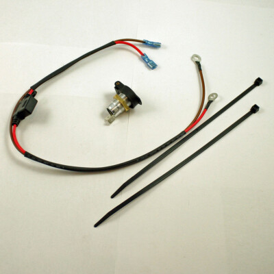

Motorworks (or ebay) sell this auxiliary power socket kit universal for £20.40, https://www.ebay.co.uk/itm/Additional-p ... SwlTBdY8ZR it comes complete with fused lead and eyelets.
Providing that the BMW OEM on-board socket and the Motorworks universal socket require the same size hole in the bodywork, it may be possible to switch one for the other, or mount elsewhere. As the socket is for use with the standard European DIN (BMW) plugs, you'd expect them to be the same size.
This thread, viewtopic.php?p=54511#p54511 shows the Motorworks universal socket fitted as an "extra" socket to a Camhead RT for battery charging.

I've done this on my last 2 RTs. Using this kit from Nippy Norman (no affiliation, similar kits are available from alternative suppliers :) ):
https://www.nippynormans.com/optimate-and-sockets/din-size-socket-kit-12v-5a-including-fuse
I've mounted the socket in the triangular panel that covers the rear brake master cylinder, on the RHS of the bike. I've connected the lead directly to the battery terminals. Useful for battery charging, and as a power take-off for an Airman compressor and heated vest, which draw too much current for the CANbus to support. I have bought a spare replacement panel, so I can remove the socket/lead and return the bike to standard when I eventually come to sell it.

How about this DIN socket for £8.00, https://www.windingroads.co.uk/din-ciga ... -accessory
With a couple of spade connectors, the now u/s Oxford charger fused pigtail lead could be made to fit.
