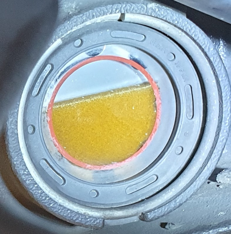

The riders manual makes the statement that oil should be checked when at op-temp. Obviously it doesn't mention thermostatic valves on oil coolers that retain oil if not at operating temperature nor does it state the level to fill the sump to with new oil after draining oil and new filter fitted. Do you measure 3.8litres minus what went in the filter on fitment and just tip it in? Do I take it for a ride with the oil (cold) in the window shown in the picture below? Am I overthinking this oil refill issue. It seems more convoluted than I am used to and certainly more involved than any Japanese bike I have ever owned.

Here's the level after filling while cold with the filter full of oil... is this the level you should have after 3.8litres of oil is added? How much higher should the oil get at operating temperature?

PS. Please understand that this picture was taken 6 days after I purchased the bike, I am 1600km from home with limited tools and cleaning/polishing gear. It was very dirty and poorly serviced as can be seen by the sand next to the oil window. I have since spent an hour cleaning just the front wheel with about a half hour to go before I start the rear wheel. It's a big job! According to servicing records the bike has done 14000km's in the last four years so likely wasn't washed and spent these years in a garage. Much work still to do so please don't judge the mess you can see as that is going to be cleaned properly once I can get home and remove the fairing for a proper clean.

I have never heard of thermostatic valves on an oil cooled bike I was always under the impression that the oil just ran around the circuit continuously and isn't like a cooling system on a water cooled bike.
But saying that I have never had an oil cooled bike or even looked in to the systems.
As for oil level thats how mine sits maybe a little higher and once warmed up and level checked its at the right level as per the manual

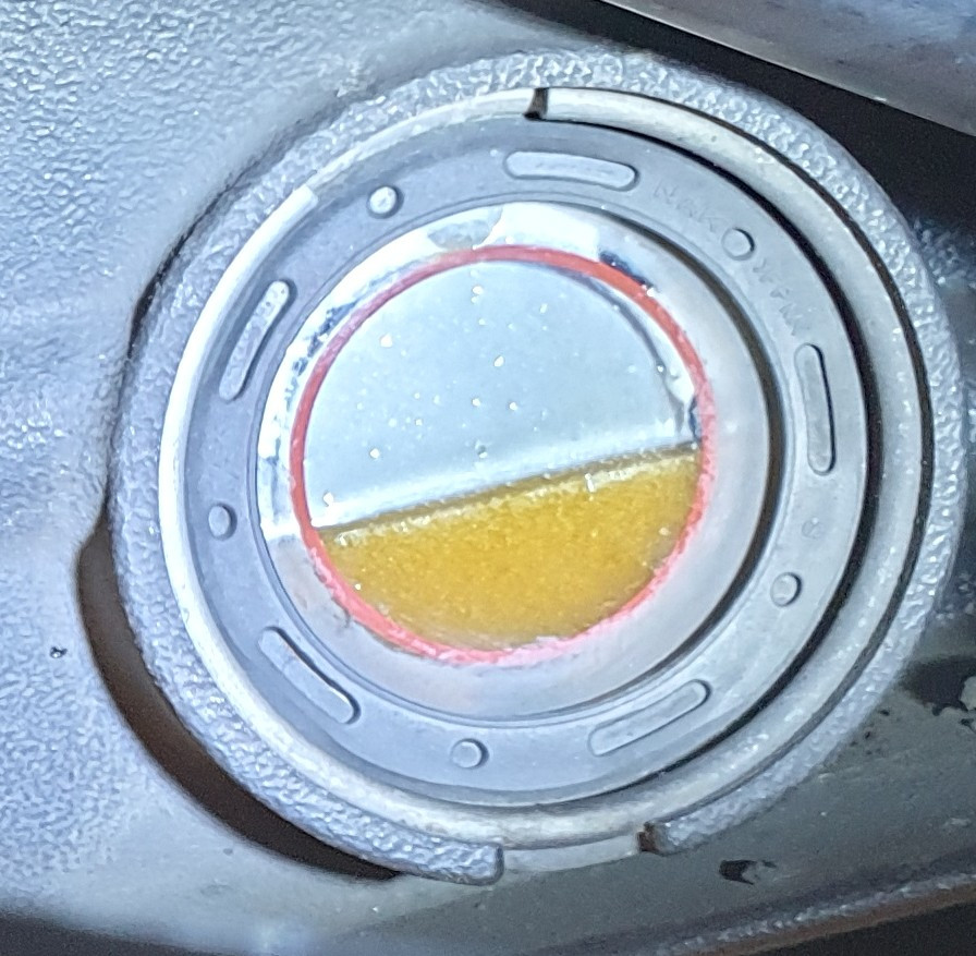

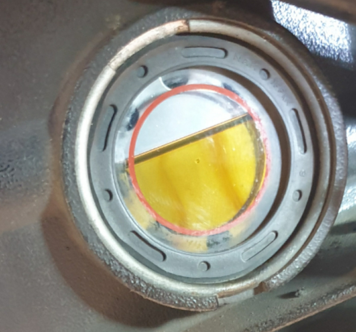

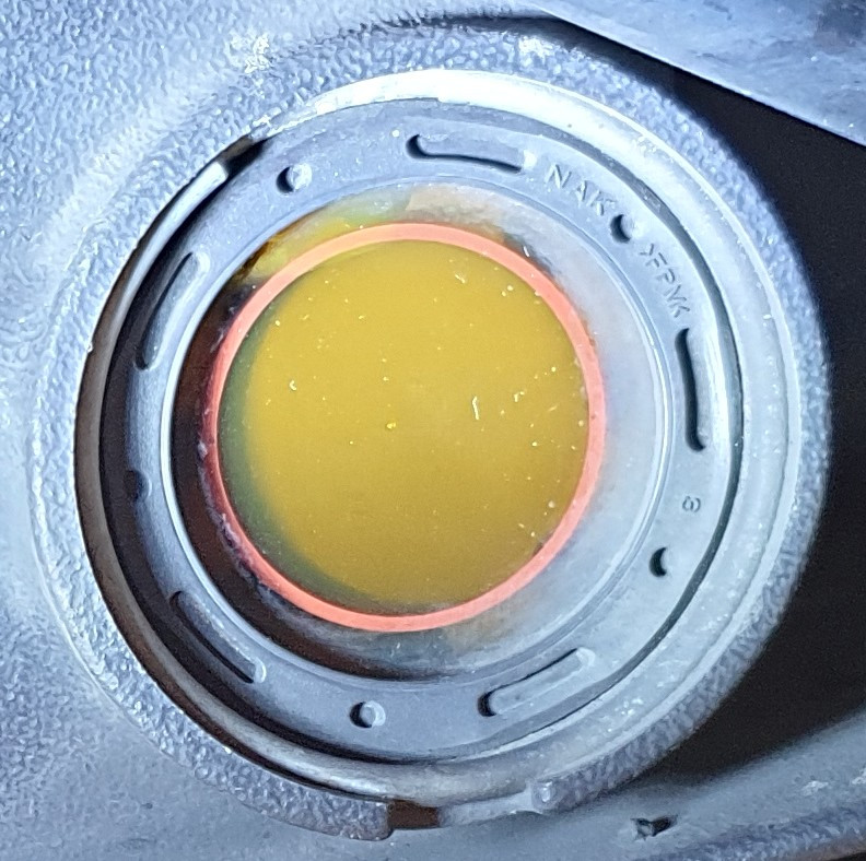

When cold after sitting overnight the window suggests it is overfilled as can be seen in the following image :
After running for 10 seconds and leaving sit a few minutes it looks like this:
After a further 20 minutes it looks like:
I imagine if I leave it it will end up looking like the first photo. Does anyone know why the oil seems to have bubbles in it?

Apparently the bubbles were caused by the oil being overfilled. Oil level is normal now with no bubbles. Of all the bikes I have owned/worked on this bike has had the biggest learning curve. 3 different oil changes and a spline grease... Are there any other things I need to be looking out for on a cam-head?

Marvin2Shoes wrote: Thu Oct 06, 2022 2:24 amApparently the bubbles were caused by the oil being overfilled.
Air bubbles are there because of oil being pumped and circulated around the engine. I'd say that the oil level is OK ref. photos 2 and three.

Except there are tiny bubbles all through the oil, not just on top. The level when hot was way above the sight glass so bubbles were causing more increase in oil volume than heat. This means to adjust the level when hot (by the manual) you would need to remove oil. After doing this (about 70-100ml removed) the oil is correct in the site window after the bike sits for 5-10 minutes after running at operating temperature. There are no bubbles showing evenly distributed in the oil now.
My problem seems to be I am used to Japanese bikes where filling with oil can be accomplished by using the level in the sight glass. From now on I will be measuring out exactly 3.8 litres.
