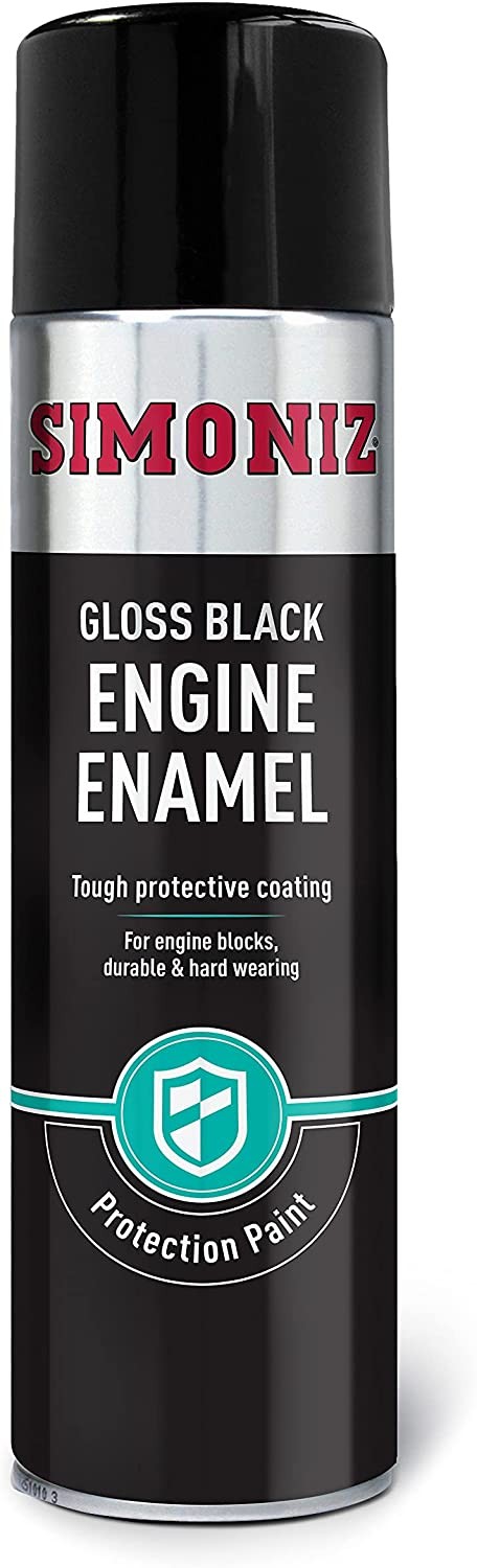

I have some SIMONIZ Engine Enamel in gloss black arriving today
I have a few pots I want to cover up on my 2016 wethead
I will update on whether this is a good match for the black engine paint
Not sure if it would be the same colour on other models
