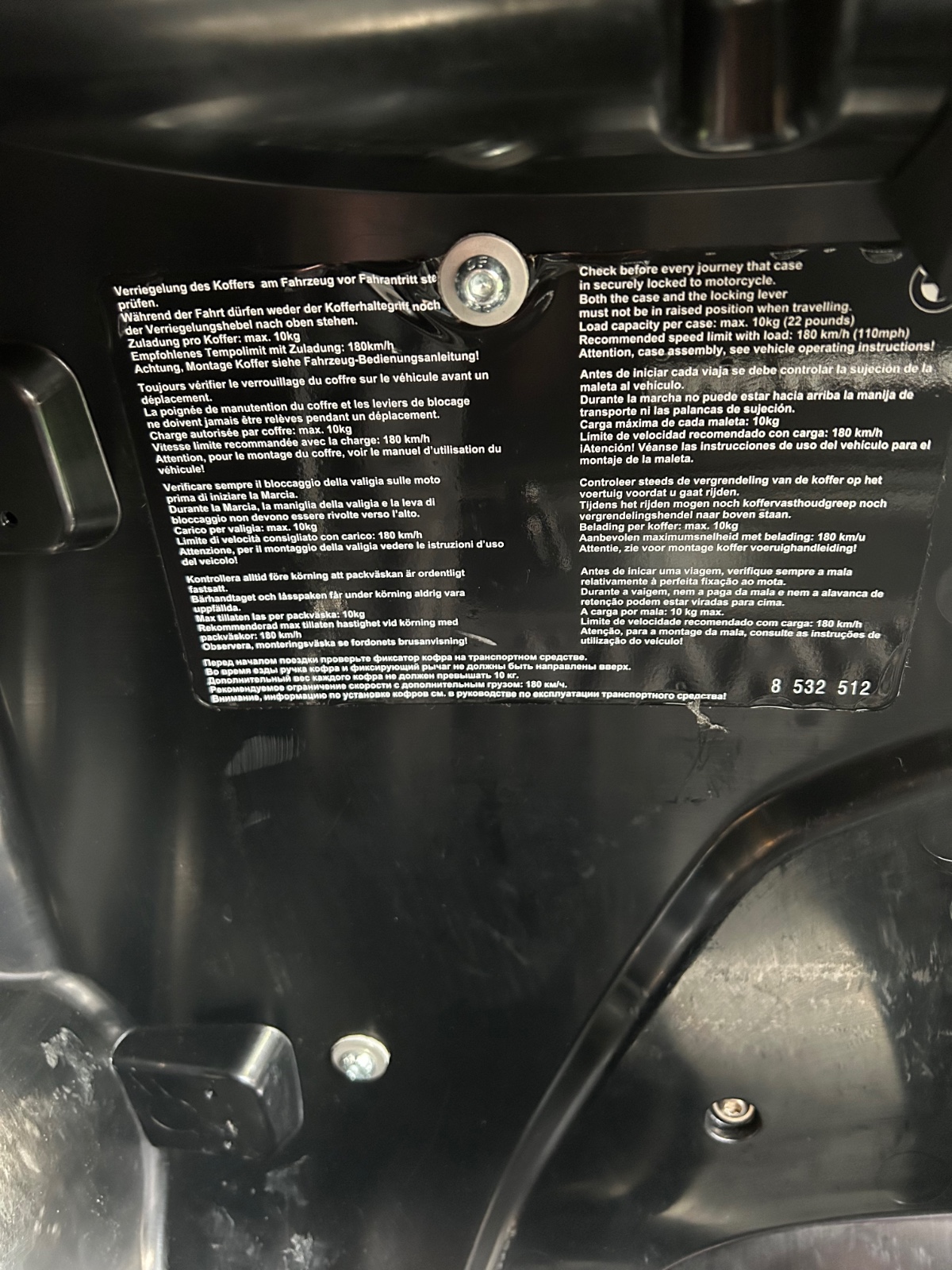

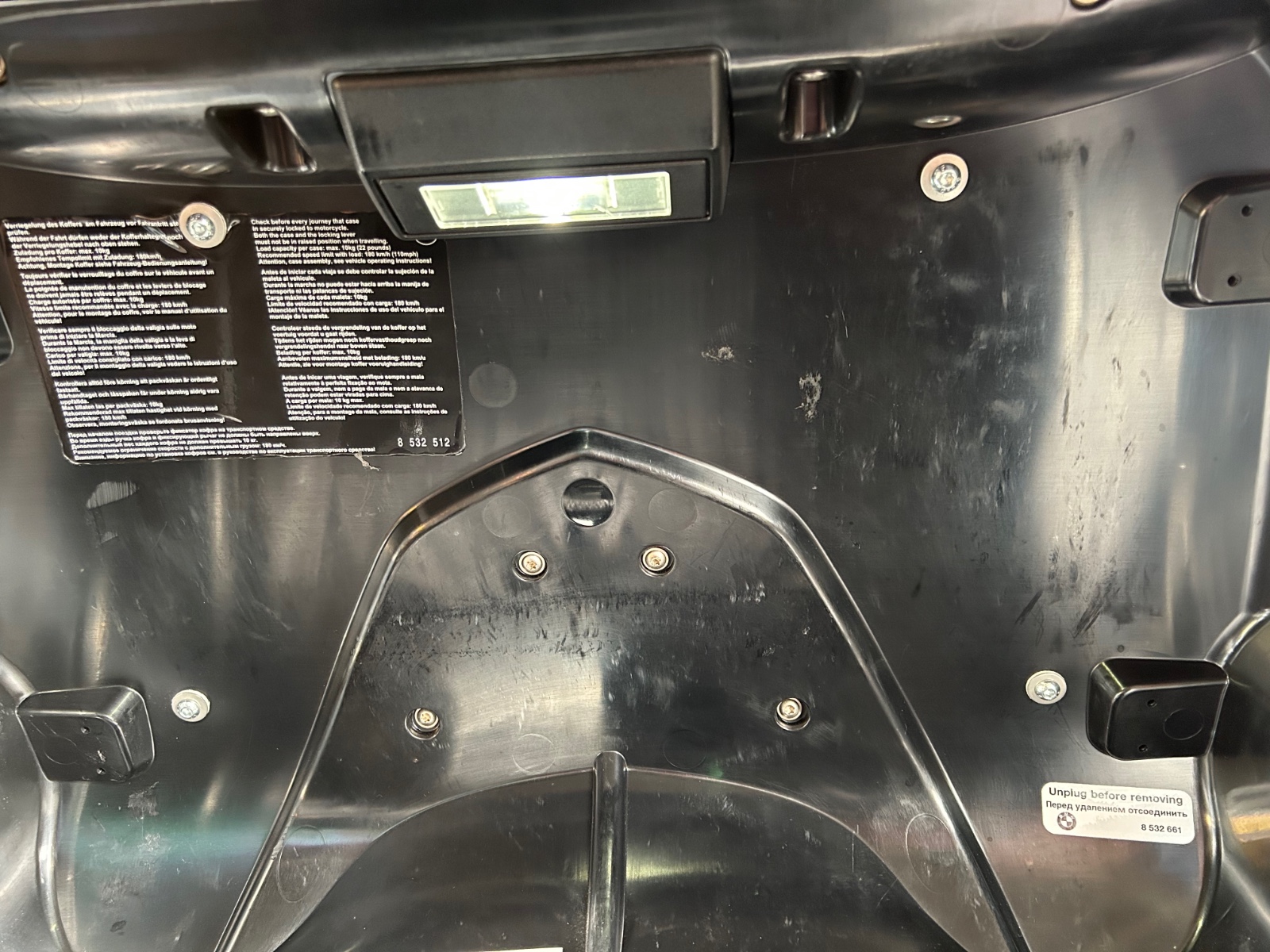

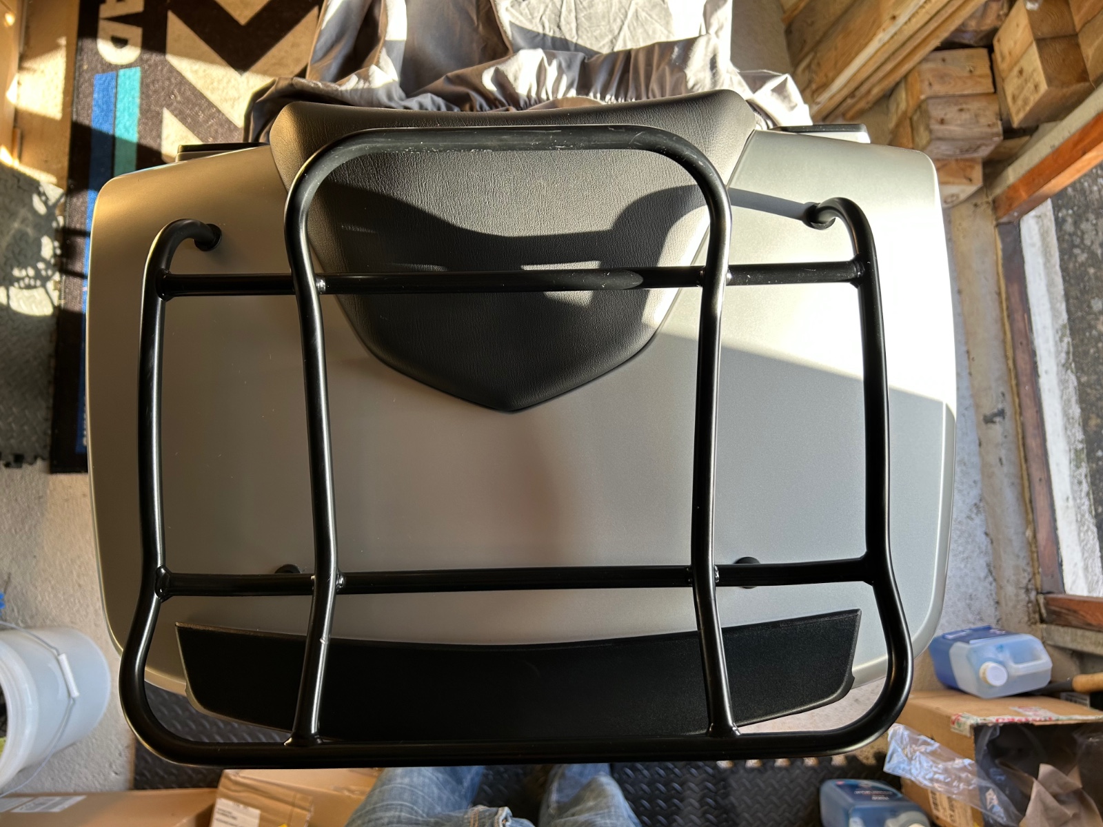

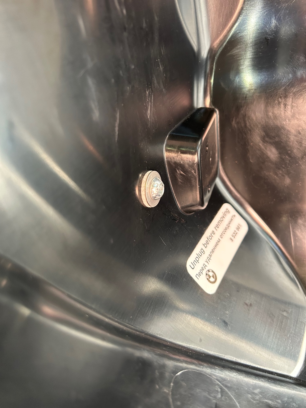

Re: OEM Top Case Luggage Rack
I’ve got one of the Wunderlich racks and can fit a shoei esprite3 and scorpion full face in together. The fitting bolts protrude millimetres into the storage area.

- David.
- Posts: 8762
- Location: North Yorkshire
- Been liked: 506 times
There is a removeable carpet mat (#4) in the base of the top case which would increase headroom.
