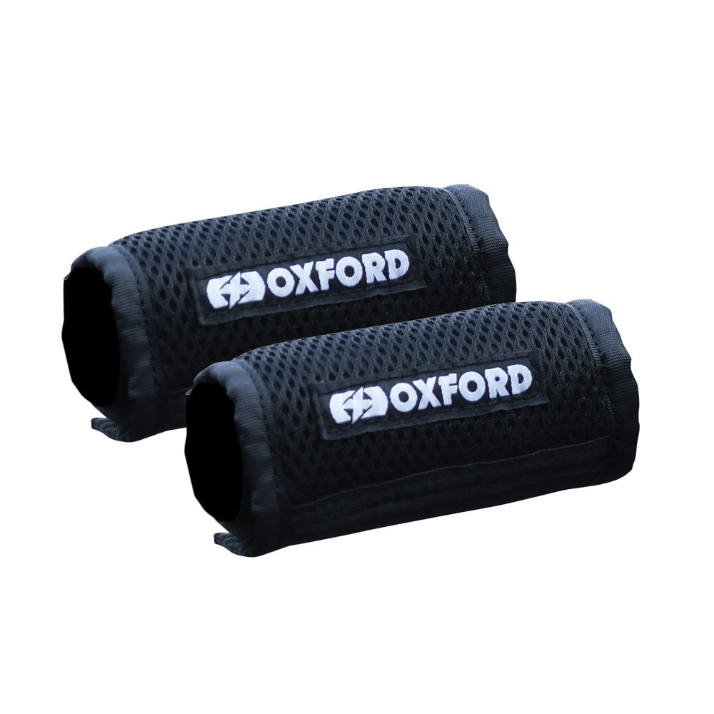

My initial plan was to try and add some paint protection to the rear grab rails as my wife does scuff them with her boots getting on. She also suffers cold hands so I thought I’d fit those wrap around Oxford heated grips but I’m not sure on the power needed to run them ?.
Also reviews say the Oxford are rubbish being either cold of burning your hands !.
Does anyone know for sure the max you can draw from the rear power port and if there’s a better alternative to the Oxford wrap arounds ?.

5 for the front/5 for the rear. You could always wire directly to the battery. I have a friend that bought a pair of cheap wrap around heated grips.
To use them on the grab handles he suggested that to first wrap the handles with tin foil. To stop the heat from dissipating into the plastic. After fitting the heated element he covered them in tennis bat tape.

Panman40 wrote: Tue Feb 21, 2023 7:32 amI’d fit those wrap around Oxford heated grips but I’m not sure on the power needed to run them.
"Draws under 3 Amps" https://www.oxfordproducts.com/motorcyc ... overgrips/
