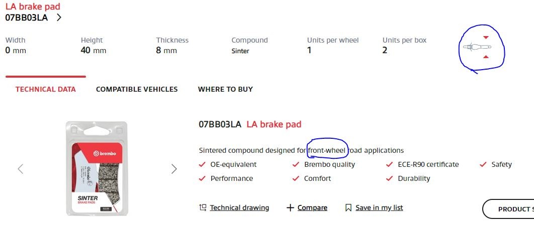

Thanks Both..... not an easy website to navigate....... several options but saying front wheel application but showing arrows at the rear wheel and doesnt list 2020 bike, Im assuming the pads didnt change at this year.
Cant find a UK supplier either..... did you guys buy them recenty in the UK and did you use the LA version?
