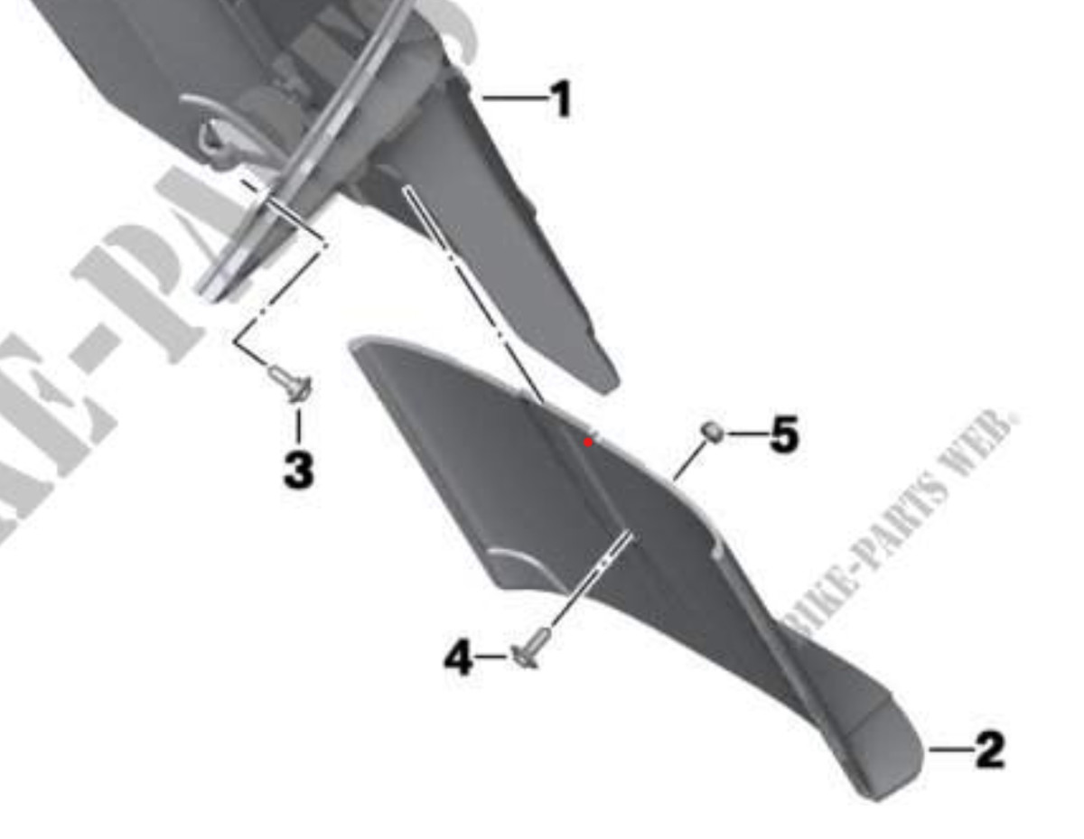

Are you doing it the right way round? The 'nut' (No5.) should be visible on the outside with the pan head bolt screwing into it from the back.
Rear Extension.jpg (79.96 KiB) Viewed 1777 times

It's an inset nut that sits in a hole shaped the same as the nut to hold it still
The trouble with this is that its a nylock and tends to turn the hold round so doesn't hold the nut and allows it to spin!
I had the issue on mine and had to drill it out to remove it all then replaced it but had to use a new nut heated up and pushed in the the plastic to make it hold
