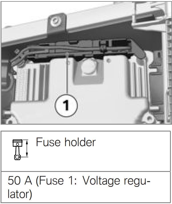

Hello all, I'm new here and hoping for some help. I just replaced the battery in my 2018 rt. Now i have absolutely no power, anywhere. Yes, the battery tests' 12+ volts and is connected correctly. I changed the battery in the key fob twice. I get no continuity between the ground connection and the frame. It sounds like there is a 50 amp fuse somewhere but I haven't been able to find it. I'm thinking the antitheft feature may have something to do with it but the dealer is giving me no information, they want to get the bike in the shop. I did check the 2 small fuses, their ok. No grounding or sparks when i changed the battery out. Any ideas? Thanks so much. I'm getting too old for this.

PlowBoy wrote: Tue May 28, 2024 5:30 pmIt sounds like there is a 50 amp fuse somewhere but I haven't been able to find it.
50A Fuse Holder.JPG (60.81 KiB) Viewed 2715 times

Post by PlowBoy »
Thanks David, i just found it and it checks ok.
