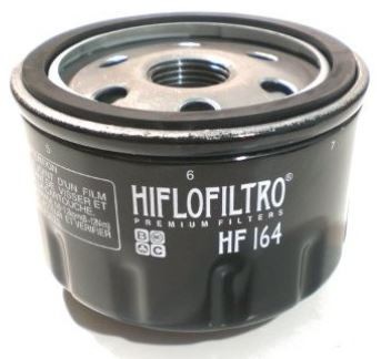

I added a HiFlo Oil filter that I ordered previously and its another shallow one like the FN164 I pulled off, then added 3.5 quarts of oil where the oil level is in the middle of glass checking window as stated online as well....

Re: OIL FILTER BLOWN OFF WHILE RIDING
Is the FN 164 a typo error, should it be a KN 164.
The STP S2808 is 86mm long/deep and is concave in the centre/thread.
The Hiflo HF 164 is 54mm long/deep and is convex in the centre/thread.
Could the filter gasket which dropped off the engine be from the original FN 164. When removing a filter, the gasket can stick to the engine and become detached from the filter.
With the potential of there being two gaskets and the concave/convex alternatives, it is possible that the STP filter was only screwed on a few threads.
With the STP filter being 32mm longer than the Hiflo, is there a chance it has grounded on something while riding along.
Was there any evidence of the "screw on" engine threads being damaged.
I doubt that oil pressure caused the STP filter to blow off.
How can a filter which is clearly not correct be cross-referenced by the parts store.
