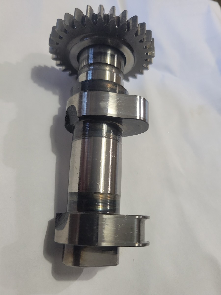

Good morning all from here in the states. I have a 2016 R1200RT. I was doing the 12k valve clearance check and noticed that my right side front intake cam lobe was wearing. My bike has 72k on it. I looked on some BMW forums and found that this does happen. Not happy about it but this is life.
I ordered a new intake cam and both rockers. Installed and took it on a 100 mile ride. Popped the valve cover off and looked at the cam. Looks like it's starting to wear again. Really not happy this time. Does anyone know if there is another reason why my Cam Lobes are wearing? Could it be that the valves are sticking? When I had the cam out, I pushed on the valve springs and I didn't feel anything abnormal.
Any help would be appreciated.
