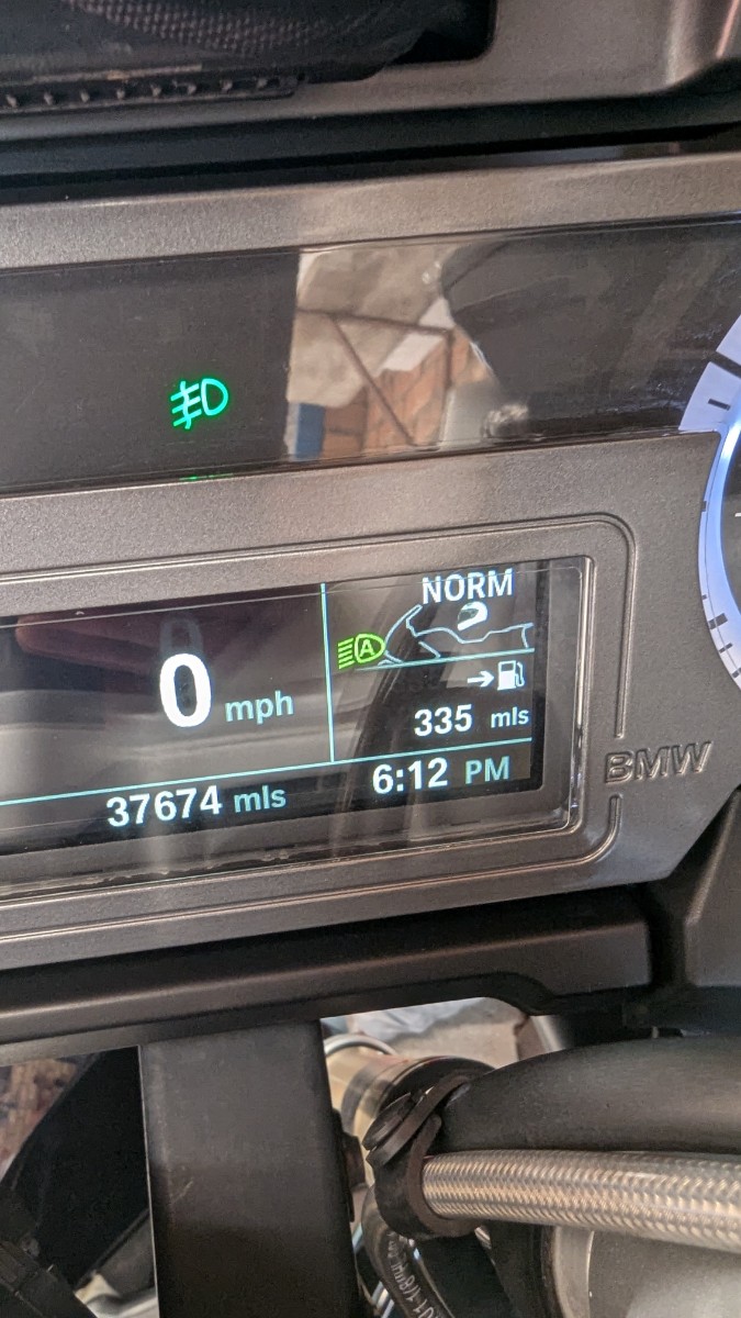

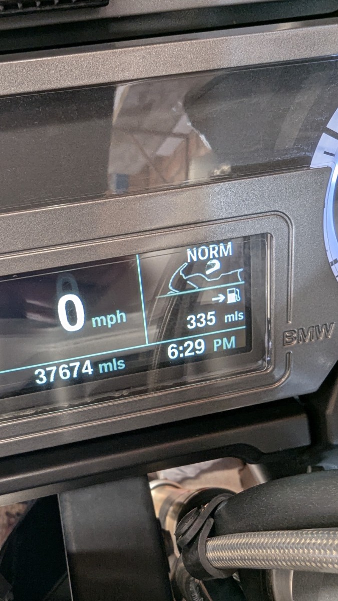

Re: Dip headlight tell tale - 2022 1250RT LE
Like so!
The A means it's in automatic mode
When it's off like so then you have turned the lights on
You cannot turn the lights off they are either on or in automatic mode
Post by Ribcracker »
Thanks Stu,
So, if I'm understanding this right...
If on mnaual mode they are on all the time
and in automatic mode they can switch themselves off in daylight? Leaving just the LED markers on?
Yes that's exactly right :thumb:
