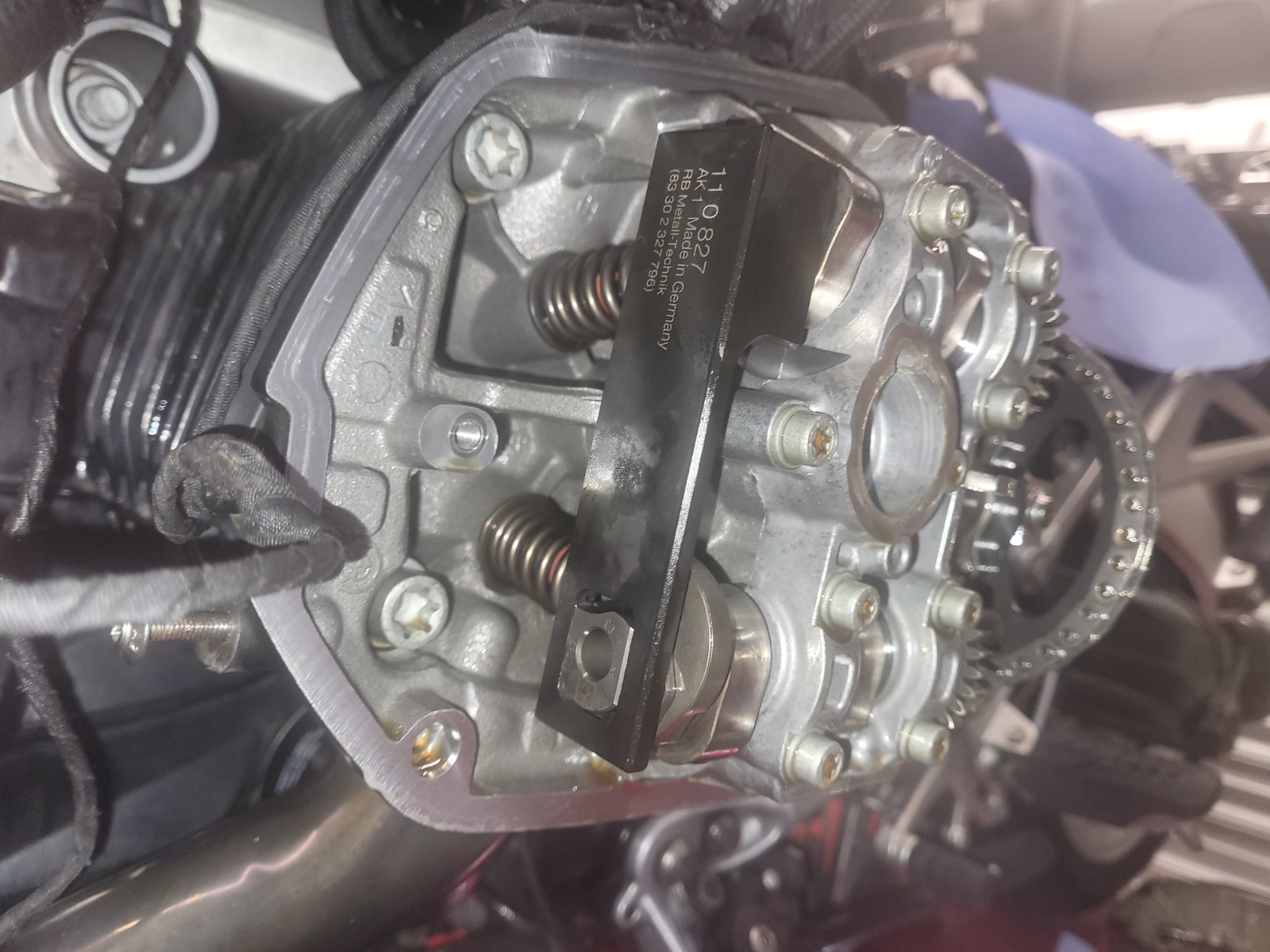

Posts: 1783
Has liked: 624 times
Been liked: 610 times
Re: BMW R1200RT Cam alignment tools
Put these tools to use today with the help @Boxflyer's videos
Also checked the valve clearances which they where all in spec
Just need to see if it starts now :lol:
Posts: 2323
Has liked: 1464 times
Been liked: 415 times
Not clear what these tools are for? Can you explain what they are used to fix? :?
