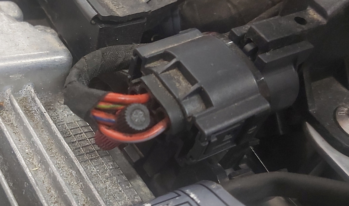

Hi CasbarCasbar wrote: Thu Dec 28, 2023 11:12 am If ACC is a switched live (which it looks like it is), then you could try the aux socket, although this is controlled via the Canbus. Or under the seat at the front is the main connection to the ignition, the orange/blue is a switched live, I use this for my Innov camera.
In the photo i have added. Is the Switch live the wire that looks like its been tapped into before ?
The wires are going to fuses in the photo.
