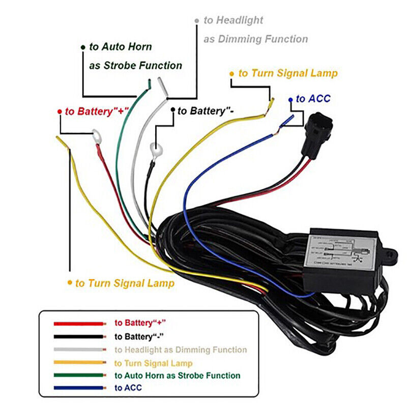

This is the wiring loom i have bought to connect to my top lights up by the headlight.
Its looks simple to fit, but just want to know where the blue wire goes to (ACC) ?
What accessory would you think it need connecting to if any.

Casbar
Posts: 2670
Been liked: 46 times
Re: Denali Auxiliary Light Mounting Brackets
Post by Casbar »
If ACC is a switched live (which it looks like it is), then you could try the aux socket, although this is controlled via the Canbus. Or under the seat at the front is the main connection to the ignition, the orange/blue is a switched live, I use this for my Innov camera.

As i will be starting to fit all the parts i bought soon. I wanted to go though some things before i started.
One of them was to make sure i 100% knew where the Blue ACC wire went.
After reading threads on about 6 car forums, I can say that "Casbar" was right about the ACC wire.
It indeed goes to a "switched live".
Thanks Casbar :thumb:
RED-------to Battery +
BLACK----to Battery -
WHITE----to Headlight Low Beam
YELLOW--to Right Indicator
YELLOW--to Left Indicator
GREEN----to Horn
BLUE------to Switch Live
