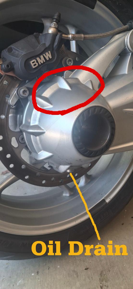

I'd like to change the Final Drive Oil. I do this on the Yamaha FJR, and it's obvious how it's done.
It's NOT Obvious on the BMW.
The following pic shows where the drain is, and where the red circle is, where the oil "input" should be.... but it's not!
The Clymer Service manual seems to show injecting the oil into a bolt that holds the brake disk in place.
Other videos show a "Filler" port on the top but with the shaft drive on the wrong side of the bike.
I have a 2008 RT. Where is the "IN" hole for the Final Drive oil?
Edit: Let me quess... You can't change the Final Drive Oil WITHOUT removing the rear wheel?
Thanks in advance.

Chat GPT says....
Filling Procedure:
Locate the Fill Hole:
On the 2008 R1200RT, the fill plug is on the rear face of the final drive, near the top.
It’s a 6mm Allen/hex bolt.
The rear face of the final drive? The mechanism seems to be round, but both faces of that circle face left and right... not back.
I will go look again.

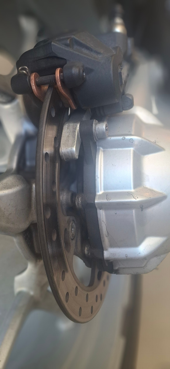

Here's the "back" of the Final Drive.
Fdrive rear 20250719_143521.jpg (114.75 KiB) Viewed 1772 times
Not helpful. the "back" of the Final drive unit, near the top, shows NO input port.
I'm beginning to realize one can't change the final drive oil without removing the rear wheel ... which is well beyond what I can do at home.
Shame on the engineer who designed that.
