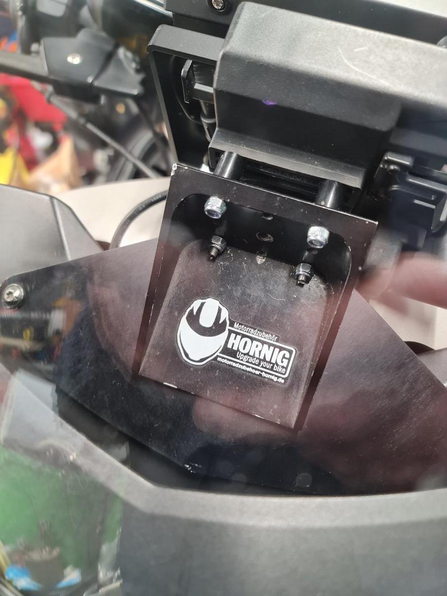

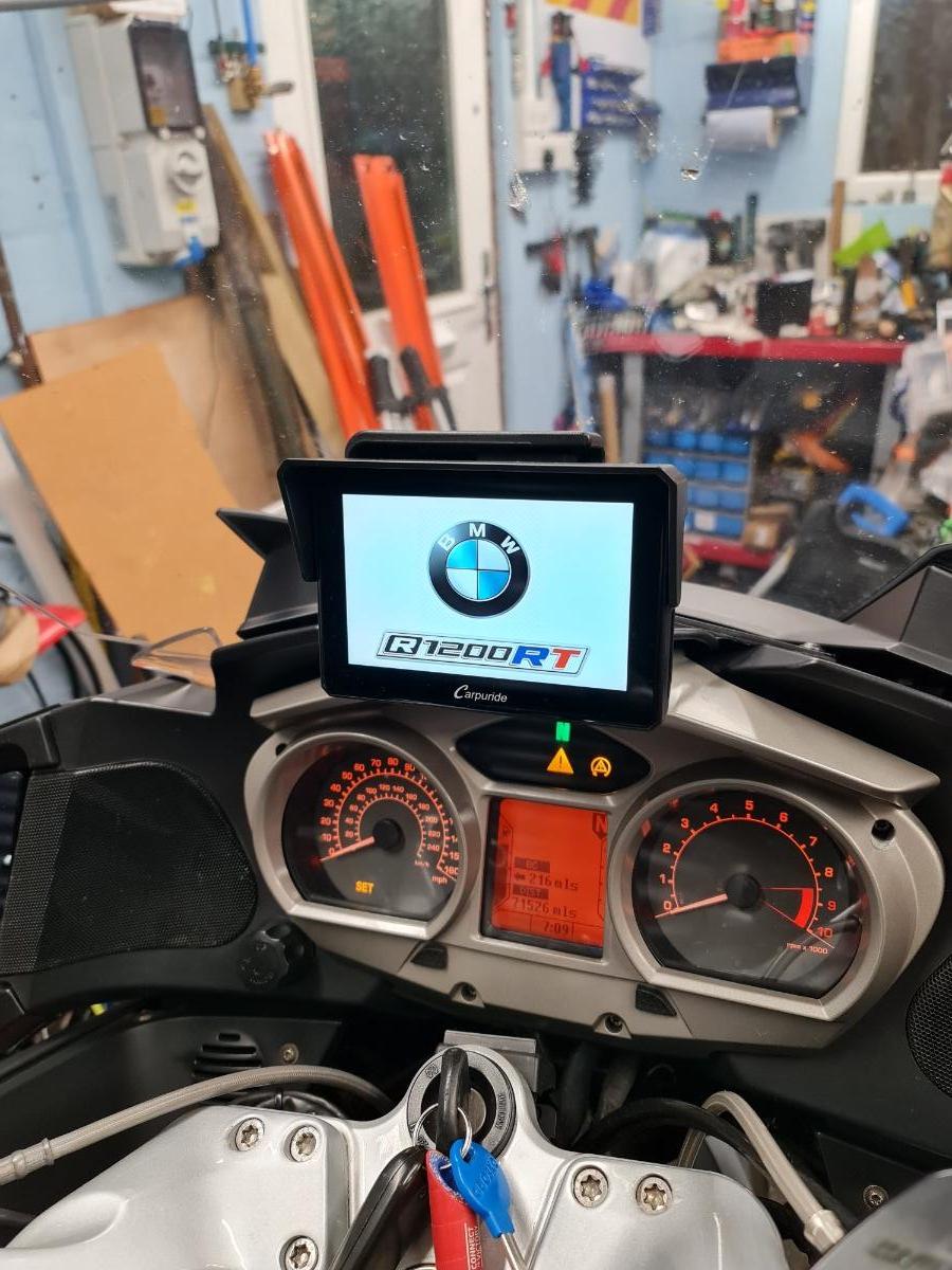

On the subject of phone/sat nav mounting/power, I have a hornig mount above the clocks but rather than a phone I've got a Carpuride mounted on a BMW Nav V mount (see pics) this connects to my phone for sat nav/music and the phone sends audio to my intercom, power is taken from a connector down by the headstock which is the BMW connector for sat navs
I can get more pics tonight if you wish

turbotim wrote: Tue Jan 21, 2025 10:13 am Welcome from a fellow Cheshire resident with a cam head (mine is a 2013 90th edition), also not long on the forum so still a newbie
