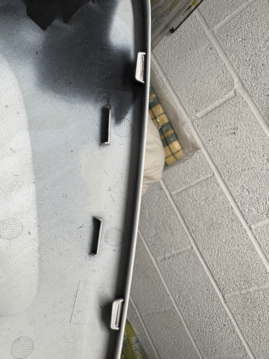

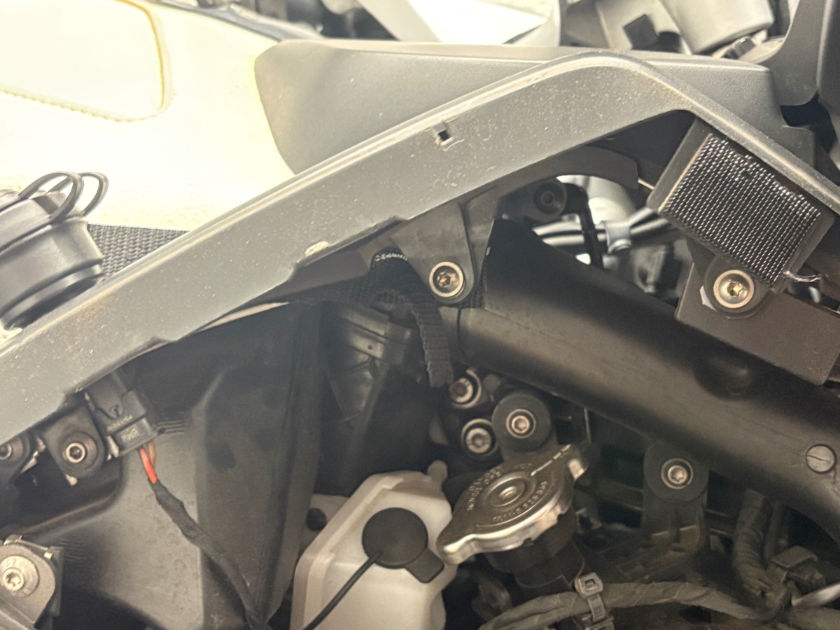

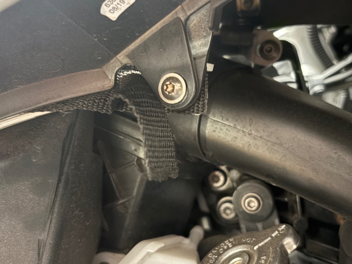

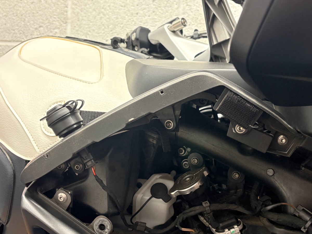

Just popped the panel off. Hopefully you can see where I put the strap on the right hand side. Also pic of the tabs to be careful of, basically remove 2 torx on tge inside of the panel at the front, pull out along the bottom until 2 poppers release and a small Velcro then gently lift the panel upwards , don’t pull it outwards as that when the tabs can snap.

Re: Bagster tank cover
Post by owl »
That is above & beyond - thank you so much for doing that for me.
I have just spent the last hour trying to feed the strap down behind that panel and failed miserably - there's just not enough room.
Armed with your photos I will have another go either this afternoon or tomorrow morning.
Post by owl »
I've got the offside strap done, thanks to those photos.
